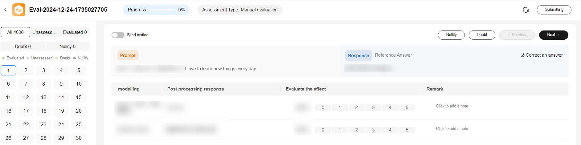

  5. When the status is To be evaluated, you can click Online Evaluation in the Operation column to go to the evaluation page.
  6. Score the evaluation effect area as prompted. After all data is evaluated, click Submit.
    • On the evaluation details page, enable Blind testing to hide the model name and perform blind testing.
    • Click Doubt or Nullify to doubt or nullify a case. To cancel this operation, click Cancel Doubts or Cancel nullify.
    • Click the Click to add a note area to add remarks.
    • On the evaluation page, hold down the left mouse button to select the text content to be marked and click Mark to mark the content as key content.
      Figure 4 Manual evaluation
