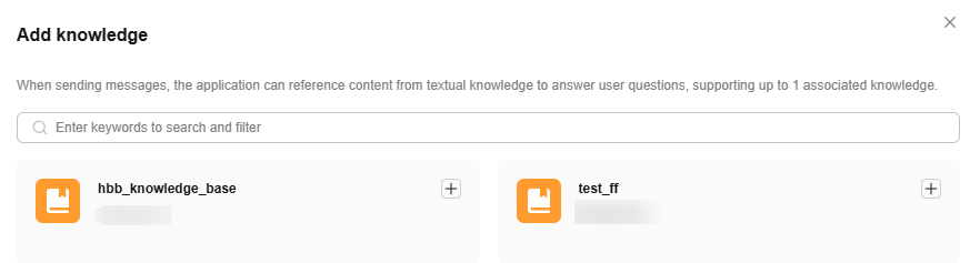

  1. In the Knowledge area, click .
  2. In the Add knowledge dialog box, click to add a knowledge base, and then click OK.
    Figure 1 Adding a knowledge base

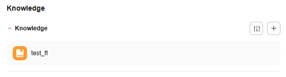

  3. In the skill > Knowledge area, view the added knowledge base.
    Figure 2 Viewing the knowledge base
