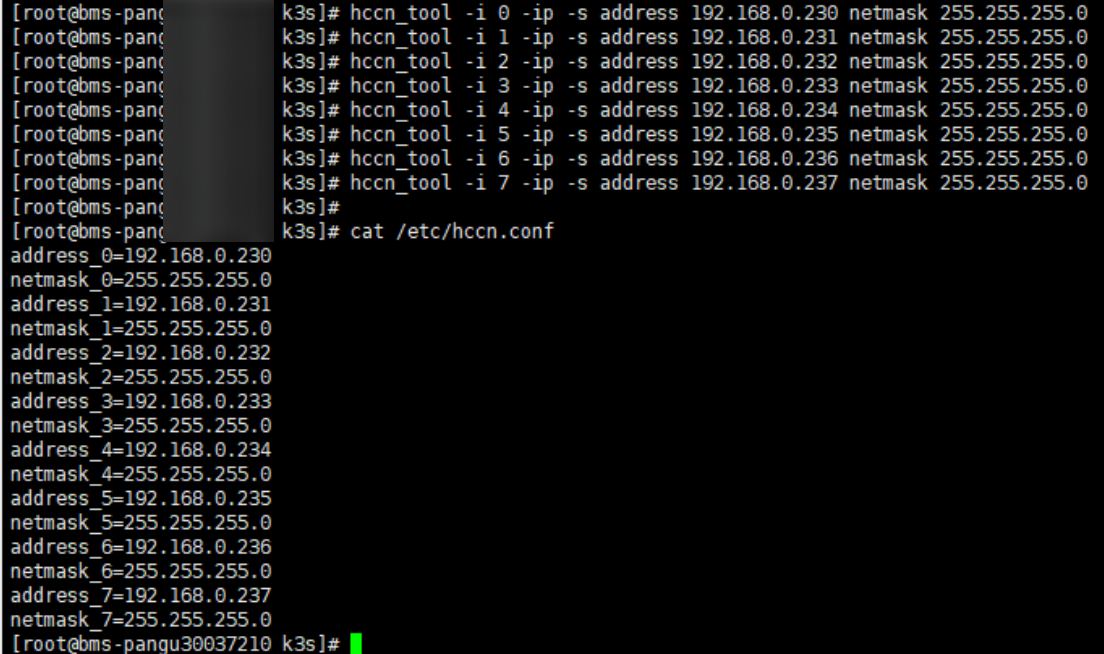

- Run the following commands (replace the IP addresses with actual ones):
hccn_tool -i 0 -ip -s address 192.168.0.230 netmask 255.255.255.0 hccn_tool -i 1 -ip -s address 192.168.0.231 netmask 255.255.255.0 hccn_tool -i 2 -ip -s address 192.168.0.232 netmask 255.255.255.0 hccn_tool -i 3 -ip -s address 192.168.0.233 netmask 255.255.255.0 hccn_tool -i 4 -ip -s address 192.168.0.234 netmask 255.255.255.0 hccn_tool -i 5 -ip -s address 192.168.0.235 netmask 255.255.255.0 hccn_tool -i 6 -ip -s address 192.168.0.236 netmask 255.255.255.0 hccn_tool -i 7 -ip -s address 192.168.0.237 netmask 255.255.255.0
- Run the cat /etc/hccn.conf command. If the following NIC information is displayed, the configuration is complete.

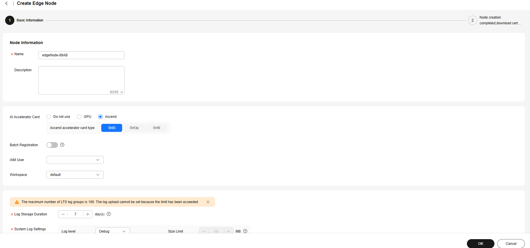

- Go to the ModelArts console and select the required workspace.
- In the navigation pane, choose Resource Management > Edge Node. On the Nodes tab page, click Create.
Figure 1 Edge Node
- On the Create Edge Node page, enter the node name and configure the AI accelerator card and log information.
- If the node has NPUs, select Ascend for AI Accelerator Card and select the accelerator card type.
- If the node does not have an accelerator card, set AI Accelerator Card to Do not use.

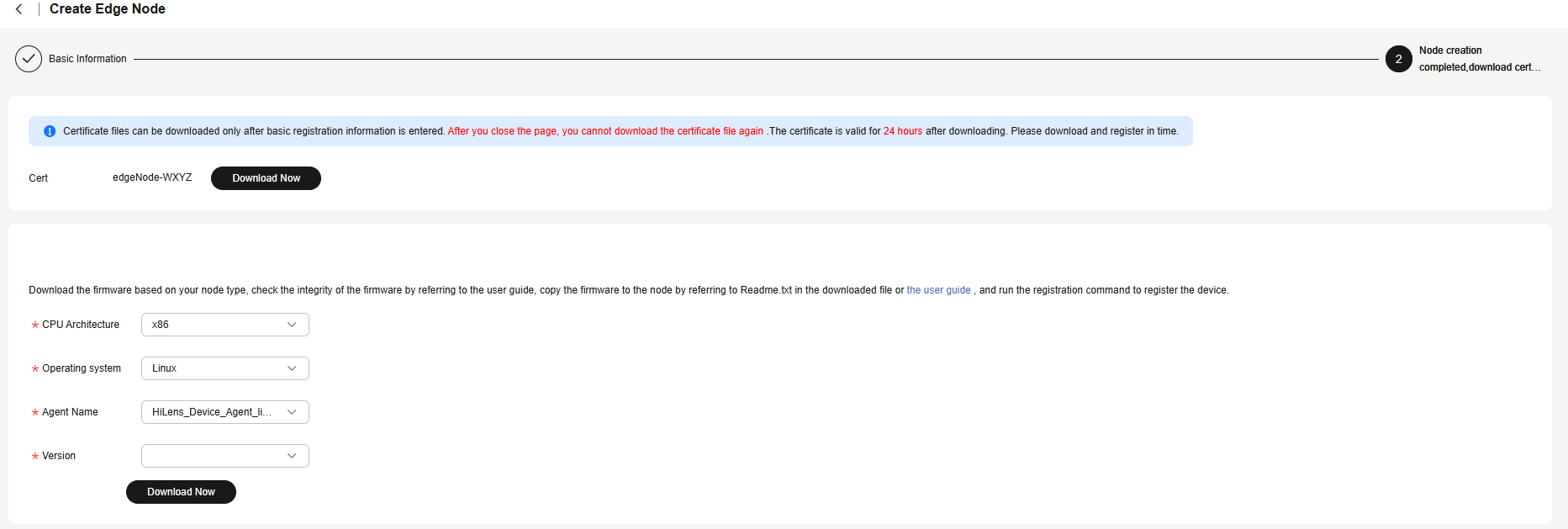

- After the basic information is configured, click OK. Click Download Now to download the device certificate and Agent firmware, and rename the device certificate and Agent firmware as license.tgz and hilens-agent.tgz, respectively.
Figure 3 Downloading the required certificate

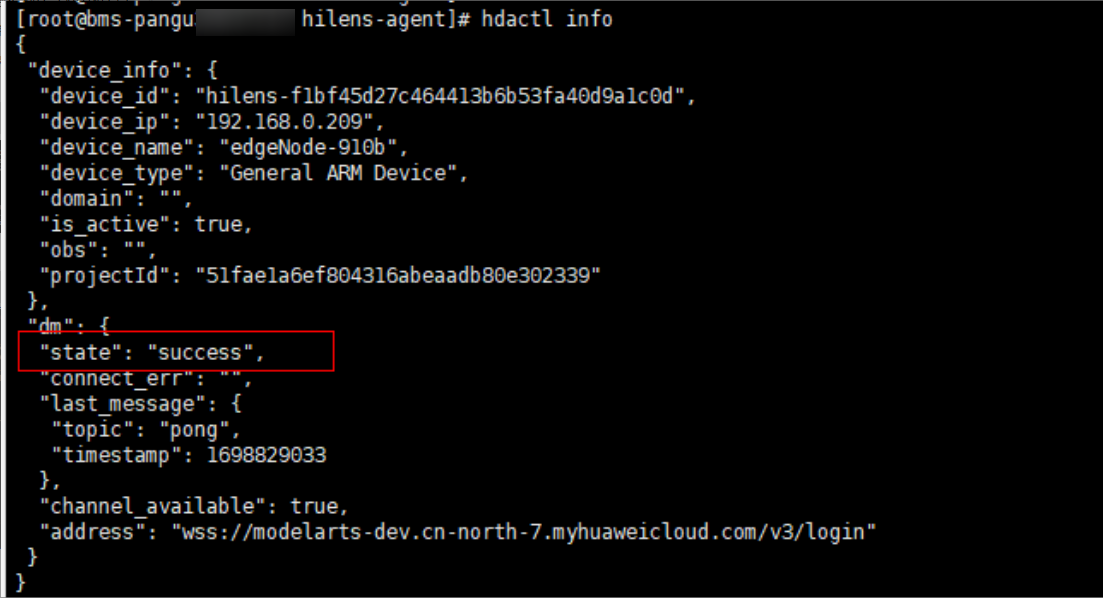

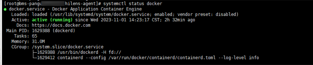

- Run the following command on the server to check whether Docker is installed:
systemctl status docker
- Run the following command on the server to check whether the edge agent is installed:
hdactl info

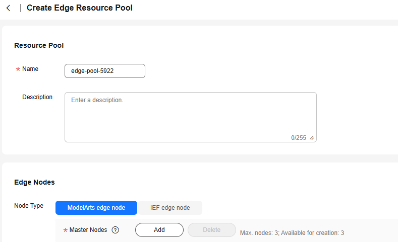

- Go to the ModelArts console and select the required workspace. Choose Edge Resource Pools > Nodes and click Activate in the Operation column of the current node. Check that the node status changes from Inactive to Active.
- Choose Edge Resource Pools > Resource Pools and click Create. Enter the resource pool name, select ModelArts Edge Node, click Add next to Master Node, select the master node to be added, and click OK.
Figure 4 Adding a master node

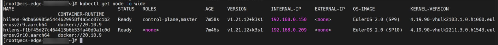

- Run the following Kubernetes command on the master node to verify the edge pool creation:
- Run the following command to set up a connection:
ln -s /home/k3s/k3s /usr/bin/kubectl
- Run the following command to query the node status:
kubectl get node -o wide
- If the status of all nodes is Ready, the cluster is created.

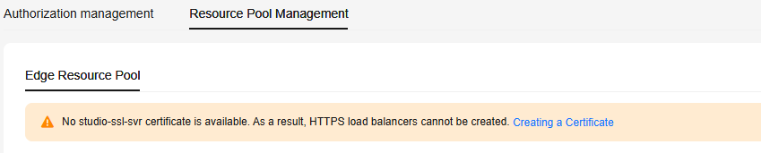

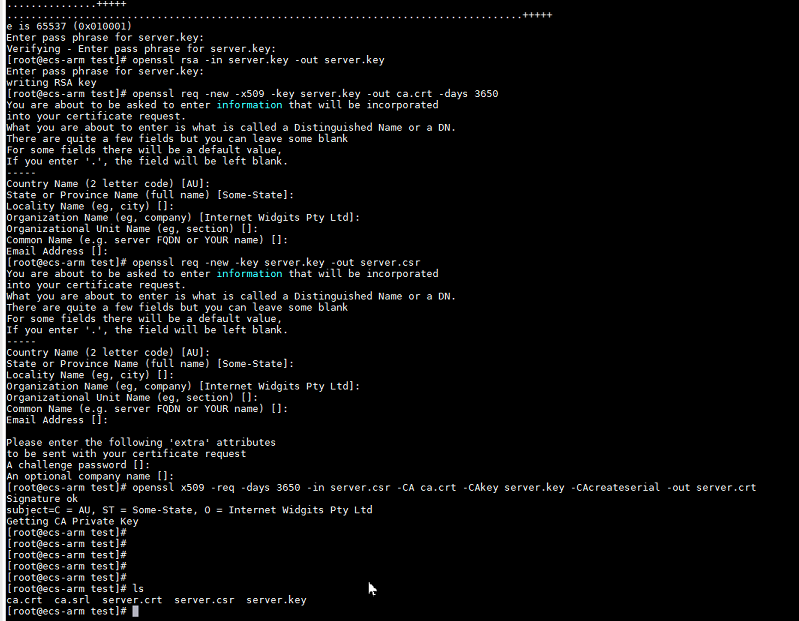

Step 4: Creating a Certificate

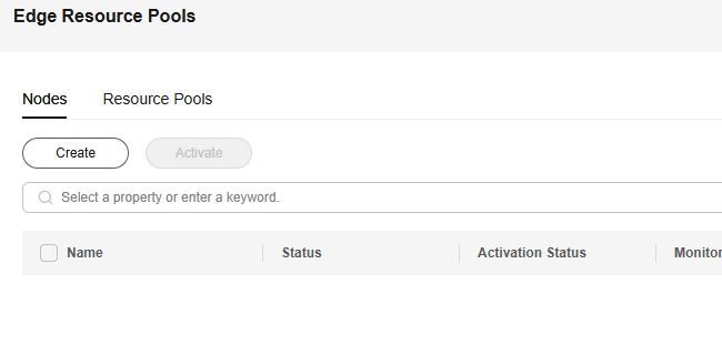

If no certificate is available on the Edge Resource Pools tab page, as shown in Figure 6, create one by referring to the following steps.
- Prepare a Linux server where OpenSSL has been installed and run the following commands to create a certificate:
When you run the command, the system prompts you to enter a password that contains at least four characters, for example, 123456. Remember the password, which will be used in subsequent steps.
1. Generate the server.key file. openssl genrsa -des3 -out server.key 2048 2. Generate an unencrypted server.key file. openssl rsa -in server.key -out server.key 3. Generate the ca.crt file. openssl req -new -x509 -key server.key -out ca.crt -days 3650 4. Generate the server.csr file. openssl req -new -key server.key -out server.csr 5. Generate the server.crt file. openssl x509 -req -days 3650 -in server.csr -CA ca.crt -CAkey server.key -CAcreateserial -out server.crt
Figure 7 Command execution example
- After the certificate is created, run the ls command to view the generated certificate file. The mapping between certificate files and certificate items on ModelArts Studio is as follows:
ca.crt -- CA server.crt -- CERT server.key -- KEY

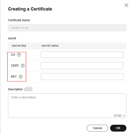

- On the ModelArts Studio homepage, click Setting in the upper right corner. On the Resource Pool Management > Edge Resource Pools tab page, click Create Certificate and set certificate parameters and description.
Figure 8 Certificate key
- You can run the view command to view the certificate key value, for example, view server.crt. The key value entered on ModelArts Studio must be encrypted using Base64 (echo -n "Copied key value" | base64).

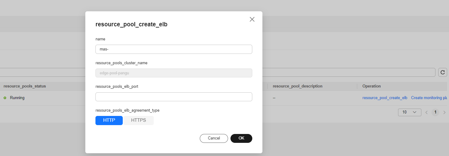

Step 5: Creating a Load Balancer
After an edge resource pool is created, go back to the homepage of ModelArts Studio and click Setting to create a load balancer and a monitoring plug-in for the edge resource pool.
To create a load balancer, perform the following steps:
- Log in to ModelArts Studio and click Setting in the upper right corner.
- On the Resource Pool Management tab page, click the Edge Resource Pool tab. View the created edge resource pool, and click resource_pool_create_elb in the Operation column.
- Enter the load balancer name (in the format of mas-xxx), set the listening port (ranging from 30000 to 40000), and set the protocol type (using HTTP or HTTPS requests for calling the inference model). Click OK.
Figure 9 Creating a load balancer
