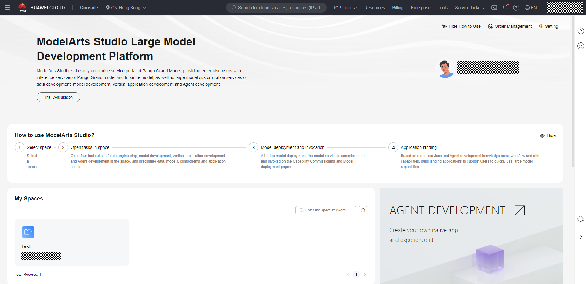

- Log in to ModelArts Studio Large Model Deveopment Platform. In the My Spaces area, click the required workspace.
Figure 1 My Spaces

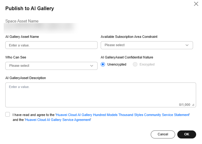

- Click Publish to Gallery in the Operation column of the data asset in Unpublished state to publish the data asset.
- In the Publish to AI Gallery dialog box, enter the AI Gallery asset name and description, available subscription area constraint, visible scope, and click OK to publish the data asset to AI Gallery.
