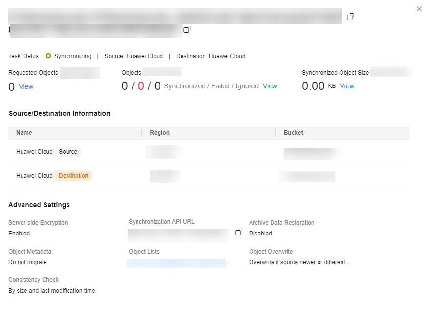

 - Click the task name or ID and view the task progress. For details about the parameters, see Table 1.
    Figure 1 View the monitoring data of a synchronization task
