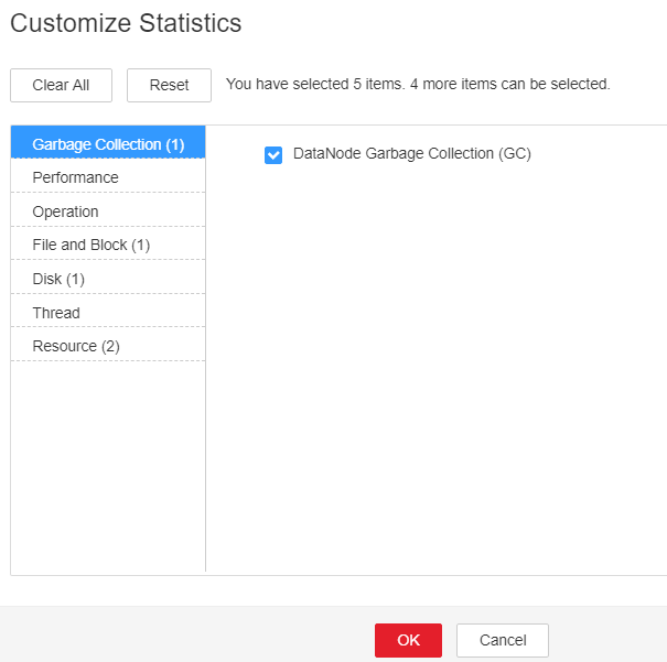

- On the Home page of FusionInsight Manager, choose Cluster > Name of the target cluster > Services > HDFS. On the page that is displayed, click the Instance tab. In the instance list, select DataNode (IP address of the instance for which this alarm is generated). Click the drop-down list in the upper right corner of the chart area, choose Customize > Garbage Collection, and select DataNode Garbage Collection (GC). Check the GC duration statistics of the DataNode process every minute. Figure 1 DataNode Garbage Collection (GC)
- Check whether the GC duration of the DataNode process collected every minute exceeds the threshold (12 seconds by default).
