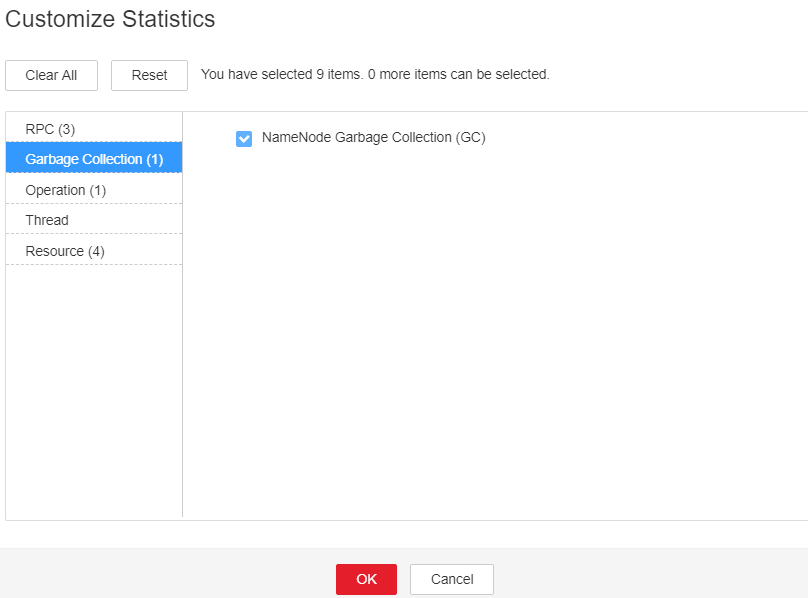

- On the FusionInsight Manager portal, choose O&M > Alarm > Alarms. On the displayed interface, click the drop-down button of ALM-14014 NameNode GC Time Exceeds the Threshold. Then check the role name in Location and confirm the IP address of the instance.
- On the Home page of FusionInsight Manager, choose Cluster > Name of the target cluster > Services > HDFS. On the page that is displayed, click the Instance tab. In the instance list, select NameNode (IP address of the instance for which this alarm is generated). Click the drop-down list in the upper right corner of the chart area, choose Customize > Garbage Collection, and select NameNode Garbage Collection (GC). Check the GC duration statistics of the NameNode process every minute.
Figure 1 NameNode Garbage Collection (GC)
