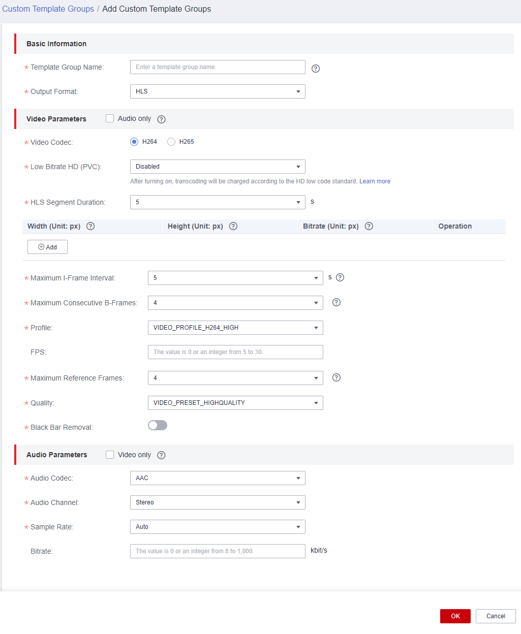

- Set Basic Information by referring to Figure 1 and Table 1.

- Configure video parameters by referring to Figure 2 and Table 2.
If Audio only is selected, the output file does not contain any video information. This option applies to the scenario where audio is extracted from a media file. Perform 6 to set audio parameters.

- Click Add to add resolutions and bitrates.
- Configure audio parameters by referring to Figure 3 and Table 4. If Video only is selected, the output file does not contain any audio information. This option applies to the scenario where video is extracted from a media file.
