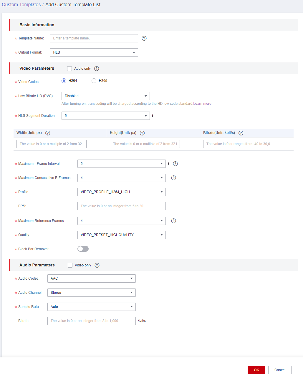

- Set Basic Information by referring to Figure 1 and Table 1.
Table 1 Basic information Parameter
Description
Template Name
Enter a maximum of 128 characters. Only letters, underscores (_), and digits are allowed.
Example: MP4_H264
Output Format
Format of an output audio or video file.
The following output formats are supported:
- Video formats: MP4, HLS, DASH, DASH+HLS, and TS
- Audio formats: ADTS and MP3
Note: If you select Audio only, the video parameters are disabled and only audio is transcoded.
- Configure video parameters by referring to Figure 2 and Table 2.
If Audio only is selected, the output file does not contain any video information. This option applies to the scenario where audio is extracted from a media file. Perform 6 to set audio parameters.

- Configure audio parameters by referring to Figure 3 and Table 4. If Video only is selected, the output file does not contain any audio information. This option applies to the scenario where video is extracted from a media file.
