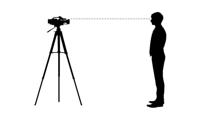

Camera Installation & Shooting Specifications
Notes:
- You are advised to use a lens with an equivalent focal length of 40 mm to 85 mm. Do not use an ultra-wide angle lens.
 - Vertically secure the camera to the tripod at a proper height. The camera is aligned with the person's eyes and focuses on the face area (see Figure 1) to ensure that the face is clear. If you record the whole body, ensure that there is a green-screen gap at the bottom of the model's feet.
 - A vertical video is recommended. The model is in the middle of the frame. Keep the margin to ensure that the model is within the frame when he or she is making a gesture. See Figure 2.
 - Avoid overexposure and underexposure.
 - The model should be at least 1.5 meters away from the green-screen background to avoid shadows.
- See Table 1.

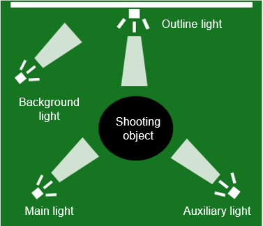

Lighting
A proper lighting environment will significantly improve the shooting. We recommend that:
- Use three or four professional photography lights for lighting, including the main light, auxiliary light, product light (for the shooting of desktop products), background light, and outline light (optional). For details, see Figure 3.
 - Ensure that the light does not change significantly during recording.
 - The green-screen background is even and bright to avoid shadows or uneven brightness. Ensure that there is no shadow or reflection between the model/object and the green-screen background.
