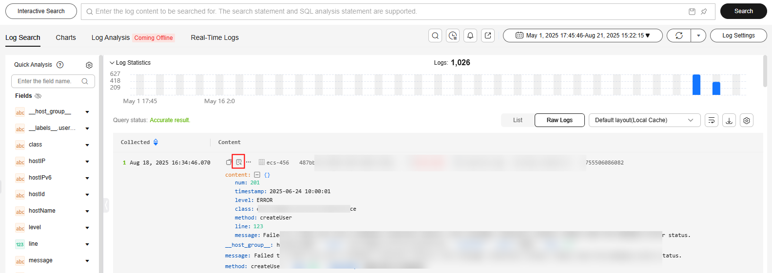

  1. Log in to the LTS console. The Log Management page is displayed by default.
  2. Click the target log group or stream to access the log details page.
  3. Click Raw Logs on the Log Search tab page and click .
    Figure 1 Viewing context of a log

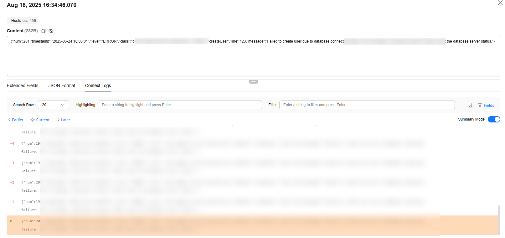

  4. On the displayed Context Logs page, check the log context. For details, see Table 1.
    Figure 2 Context logs
    Table 1 Viewing context logs
    Feature
    Description
    Search Rows
    Select the number of lines of logs to be queried as required.
    Highlighting
    Enter a string to be highlighted and press Enter.
    Filter
    Enter a string to be filtered and press Enter. When both Highlighting and Filter are configured, the filtered string can also be highlighted.
    Fields
    The default field for viewing log context is content. Click Fields to view the context of other fields.
    Prev
    View half the number of Search Rows leading to the current position. For example, if Search Rows is set to 100 and you click Prev, 50 rows prior to the current position are displayed. In this case, the current line number is -50. If you click Prev again, the line number will become -100, -150, -200, and so on.
    Current
    Current log position. When Prev or Update is set, you can click Current to return to the position where the context starts (when the line number is 0).
    Update
    View half the number of Search Rows following the current position. For example, if Search Rows is set to 100 and you click Update, 50 rows following the current position are displayed. In this case, the current line number is 50. If you click Update again, the line number will become 100, 150, 200, and so on.
    Summary Mode
    • If this mode is enabled, only the line number and content are displayed.
    • If this mode is disabled, log details are displayed.
    Download
    Only content in the content field can be downloaded to the local PC.
