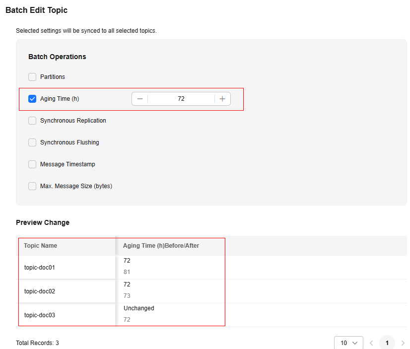

- Select the desired topics and click Batch Edit Topic above the list.
- In the Batch Operations area, select Aging Time (h) and enter a value (range: 1 to 720). In the Preview Change area, check the aging time before and after the modification and click OK.
Figure 1 Batch modifying the aging time
Check the new aging time on the Topics page.
