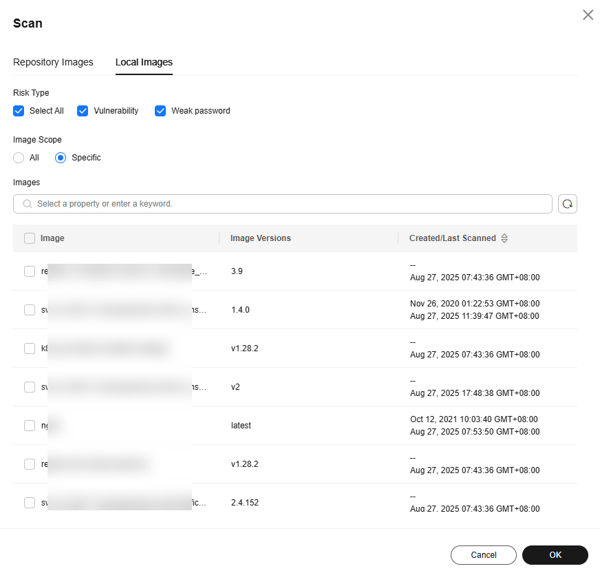

 - In the upper right corner of the page, click Scan.
To scan a single image, click the Image View tab, click Scan in the Operation column of the image.
 - Click the Local Images tab and configure parameters. For details, see Table 1.
     Figure 1 Manually scanning local images
     Table 1 Local image scan parameters Parameter
Description
Example Value
Risk Type
Select Vulnerability and Weak password, if needed.
HSS scans for software information by default. You do not need to select it.
Select All
Image Scope
Select All or Specific.
A full scan takes a long time and cannot be stopped once started. Exercise caution when performing this operation.
Specific
