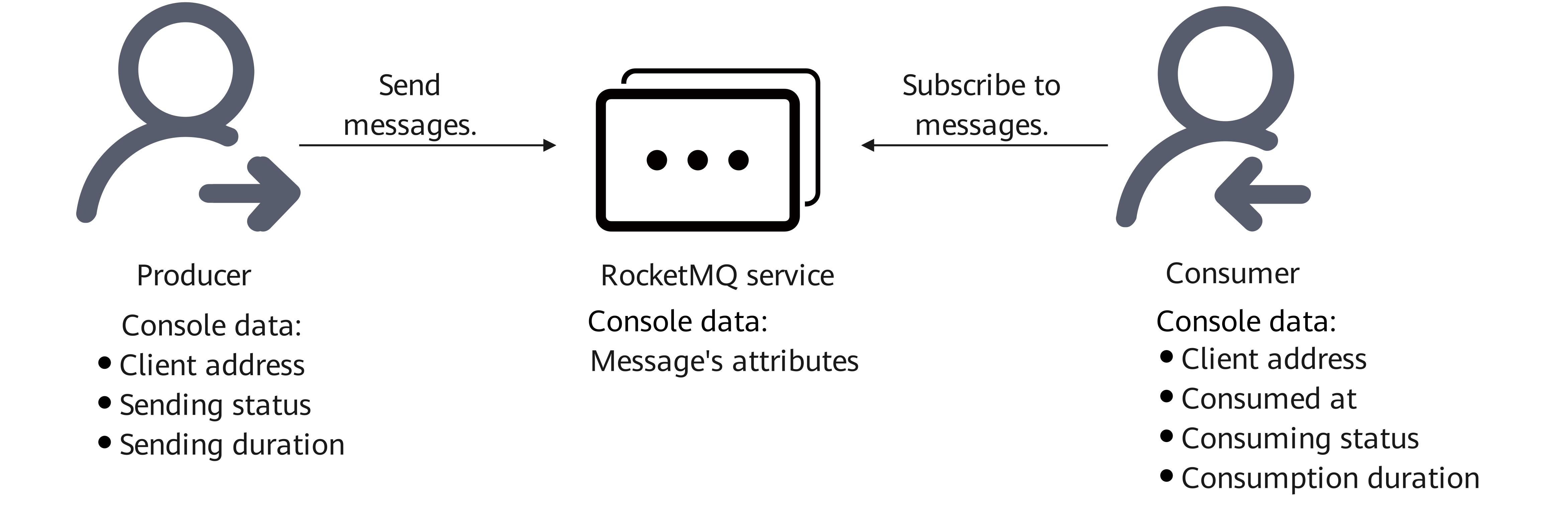

Message traces contain complete time and location information during production and consumption of a message. Message tracing enables diagnosis of real messaging status when exceptions (e.g., production and consumption failures) occur. Message traces can be queried by message ID, message key, or topic time range.
Message Tracing Data
The trace of a RocketMQ message involves the producer, server, and consumer. Each role adds information to the trace when processing a message. These information shows the status of any message.

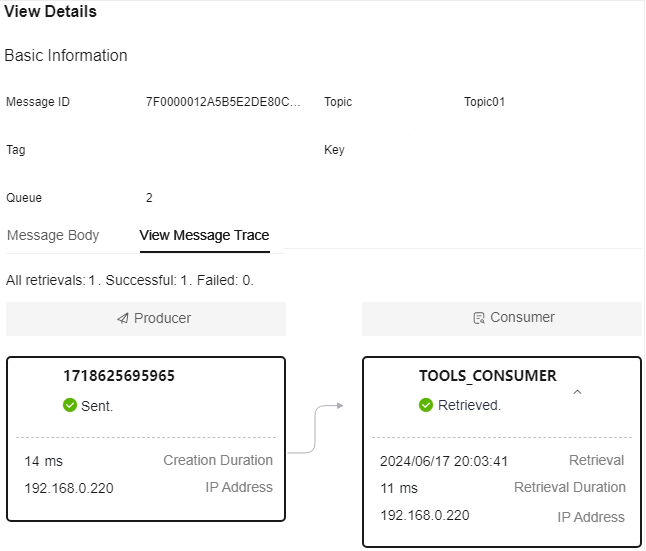

- Locate the row containing the message to be queried. Click View Message Trace.
- View the message trace to check whether the message is successfully produced or consumed, as shown in Figure 5.
Table 2 describes message trace parameters.
Table 2 Message trace parameters Parameter
Description
Producer status
A producer can be in one of the following states:
- Sent: The message is sent successfully, and the server has successfully stored the message.
- Committed: The message can be retrieved by consumers.
- Rollback: The message will be discarded and cannot be retrieved by consumers.
- Unknown: The status of the message cannot be determined. After a period of time, the server initiates a check request to the producer.
Creation duration
Time taken to send the message by the producer.
Unit: millisecond
Producer address
IP address of the producer.
Consumer status
A consumer can be in one of the following states:
- Retrieved
- Retrieval timed out
- Abnormal retrieval
- NULL returned
- Retrieval failed
Retrieved
Time when the message is retrieved.
The time format is YYYY/MM/DD hh:mm:ss.
Retrieval duration
Time taken to retrieve the message by the consumer.
Unit: millisecond
Consumer address
IP address of the consumer.
