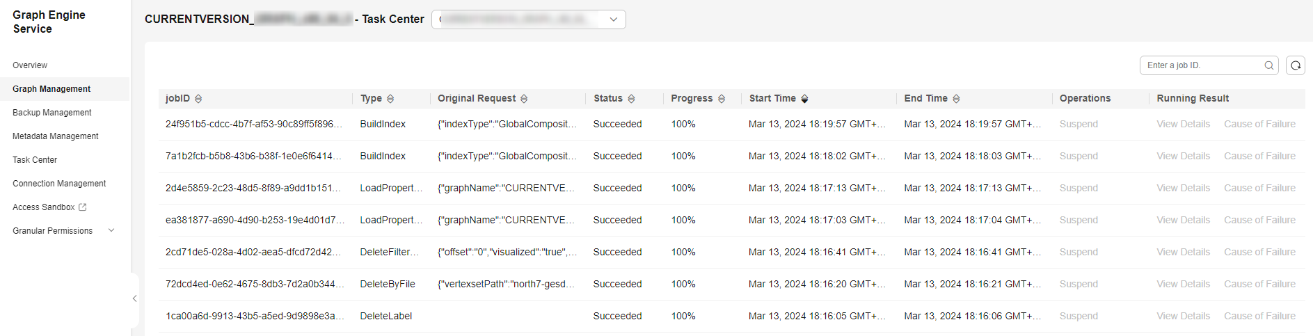

The task center allows you to view details about the historical tasks and asynchronous tasks that are being executed.
The procedure is as follows:
- In the navigation pane, choose Graph Management. On the displayed page, locate the target graph and choose More > Task Center in the Operation column.
Figure 1 Query task center
- The query task center is available for graphs of version 2.2.23 and later.
- You can access the query task center of graphs that are in the running, importing, exporting, or clearing states only.
- In the upper left corner of the Task Center page, select a node from the drop-down list to view details about the asynchronous tasks that are being executed or have been executed. The following task information is displayed:
- Job ID: Job ID of an asynchronous task
- Graph Name: name of graphs of the database edition
- Task Type: Type of the asynchronous task, including ImportGraph and VertexQuery
- Original Request: Original request body sent by the user
- Status: Task status, which can be Suspended, Running, Succeeded, or Failed
- Progress: Progress of the task
- Start Time: Time when the task starts. If the task does not start, the start time is empty.
- End Time: Time when the task ends. If the task does not end, the end time is empty.
- Operation: You can suspend the task.
- Running Result: You can view the task details. If the task fails, you can view the failure cause.
- To view details about an asynchronous task, search the task by its job ID using the search box in the upper right corner of the page.
