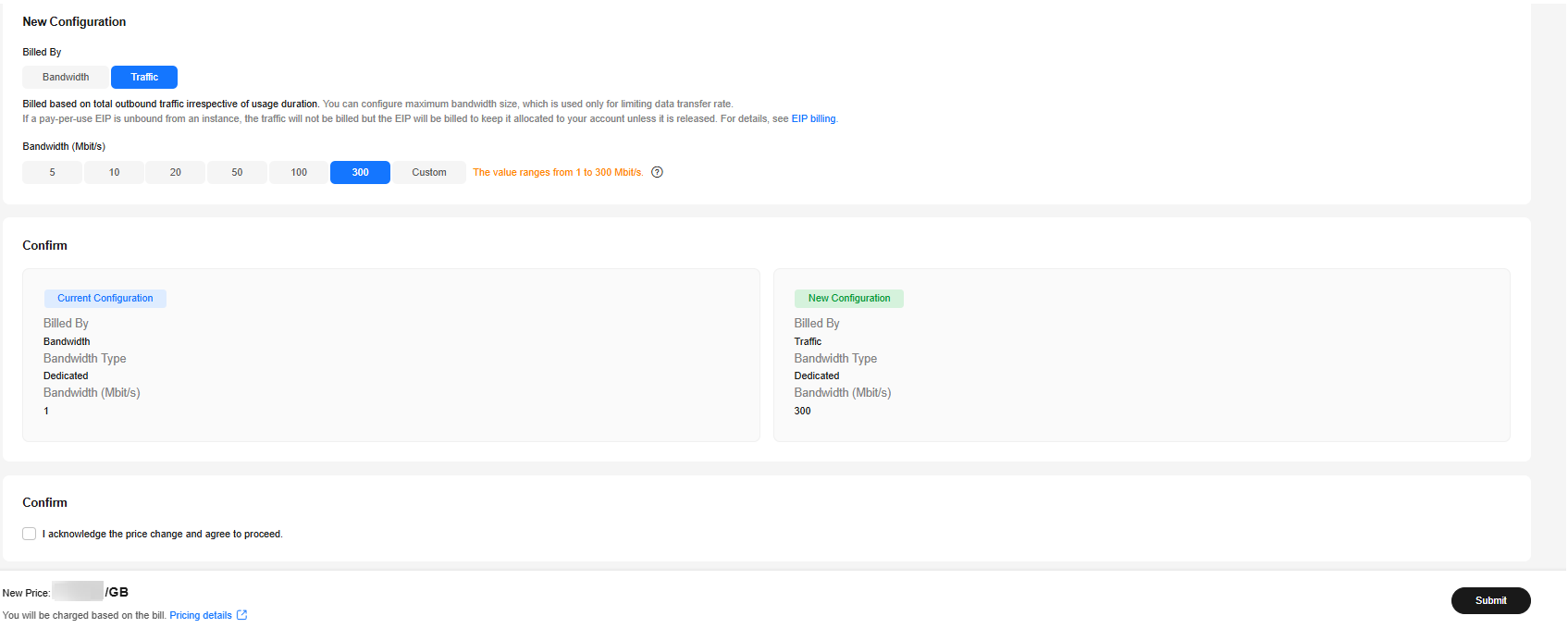

 - Follow the instructions to modify the bandwidth.
 - Confirm the new configuration, select I acknowledge the price change and agree to proceed, and click Submit.
     Figure 1 Confirming the new configuration

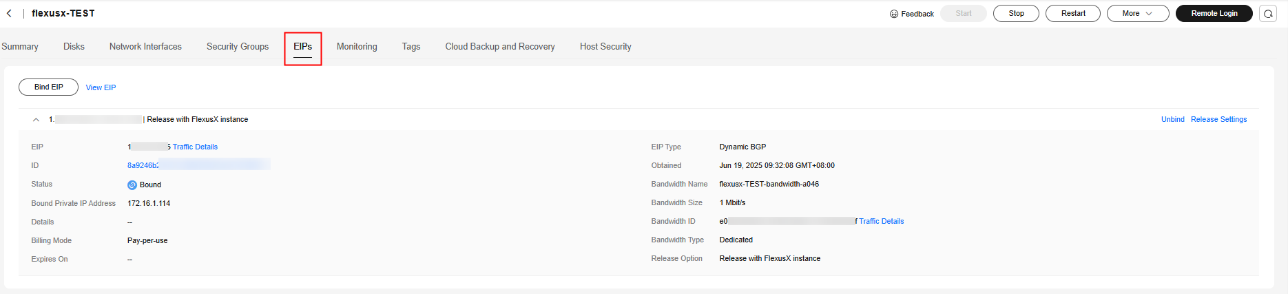

      - After the modification is complete, you can view the details on the EIPs tab of the FlexusX instance details page.
     Figure 2 Viewing the bandwidth information
