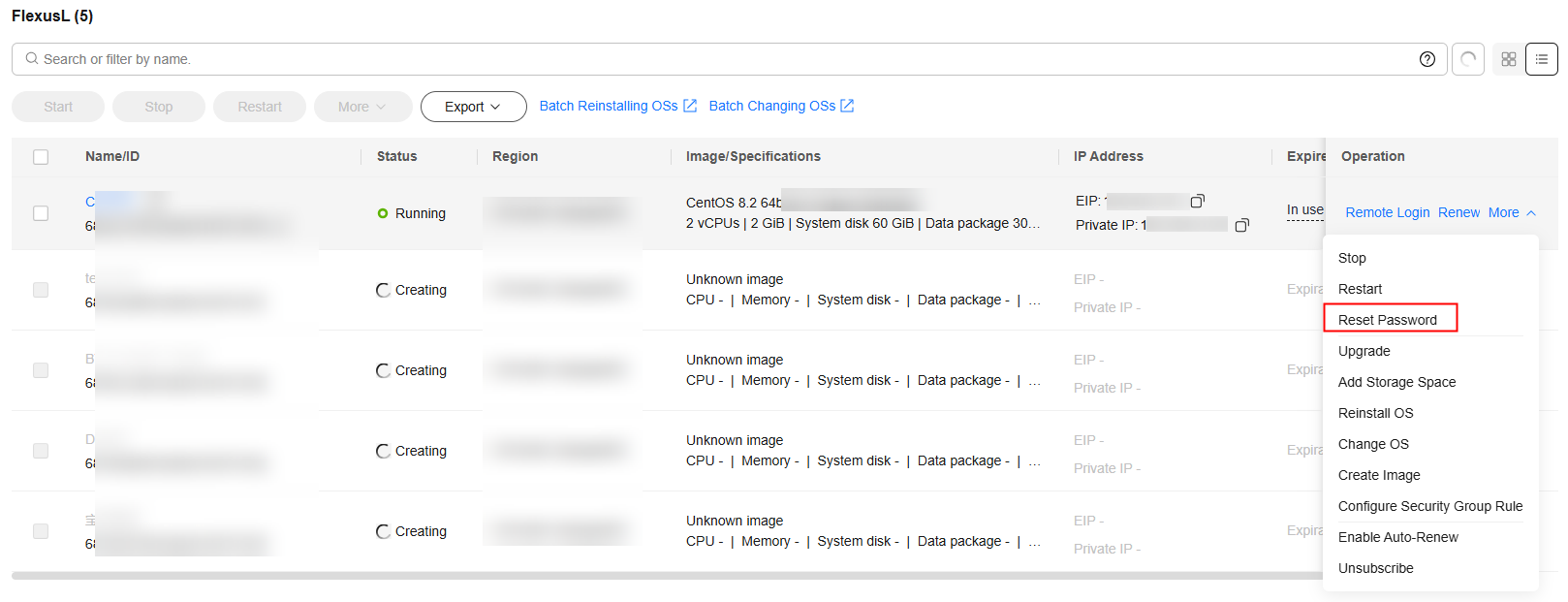

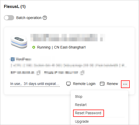

- Log in to the FlexusL console.
By default, FlexusL instances are displayed in the card view. You can also click
to switch to the list view. - Reset the password for one or more FlexusL instances.
- Resetting the password for logging in to a single FlexusL instance using any of the following methods:
