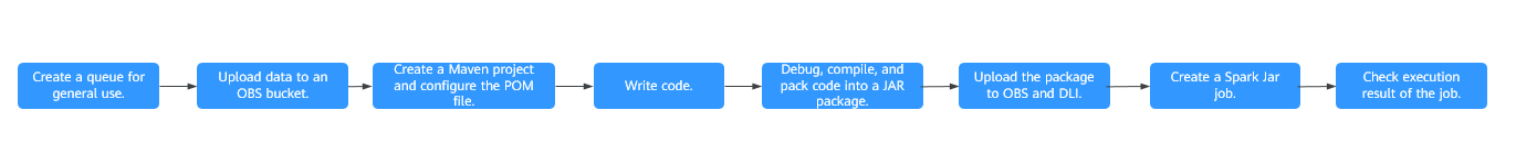

Development Process
| No. | Phase | Software Portal | Description |
| 1 | Create a queue for general use. | DLI console | The DLI queue is created for running your job. |
| 2 | Upload data to an OBS bucket. | OBS console | The test data needs to be uploaded to your OBS bucket. |
| 3 | Create a Maven project and configure the POM file. | IntelliJ IDEA | Write your code by referring to the sample code for reading data from OBS. |
| 4 | Write code. | ||
| 5 | Debug, compile, and pack the code into a Jar package. | ||
| 6 | Upload the Jar package to OBS and DLI. | OBS console DLI console | You can upload the generated Spark JAR package to an OBS directory and DLI program package. |
| 7 | Create a Spark Jar Job. | DLI console | The Spark Jar job is created and submitted on the DLI console. |
| 8 | Check the job execution result. | DLI console | You can check the job status and run logs. |

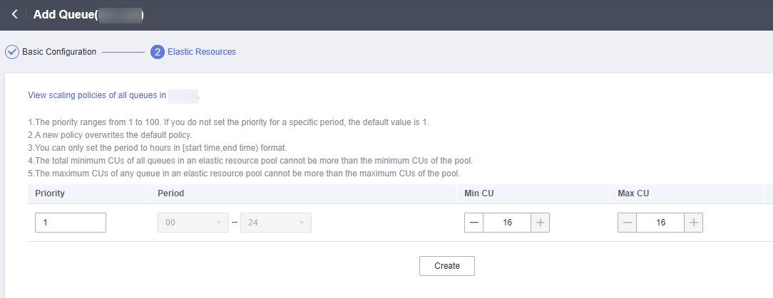

- Click Next and configure scaling policies for the queue.
Click Create to add a scaling policy with varying priority, period, minimum CUs, and maximum CUs.
Figure 2 shows the scaling policy configured in this example.Table 5 Scaling policy parameters Parameter
Description
Example Value
Priority
Priority of the scaling policy in the current elastic resource pool. A larger value indicates a higher priority. In this example, only one scaling policy is configured, so its priority is set to 1 by default.
Period
The first scaling policy is the default policy, and its Period parameter configuration cannot be deleted or modified.
The period for the scaling policy is from 00 to 24.
00–24
Min CU
Minimum number of CUs allowed by the scaling policy
16
Max CU
Maximum number of CUs allowed by the scaling policy
64

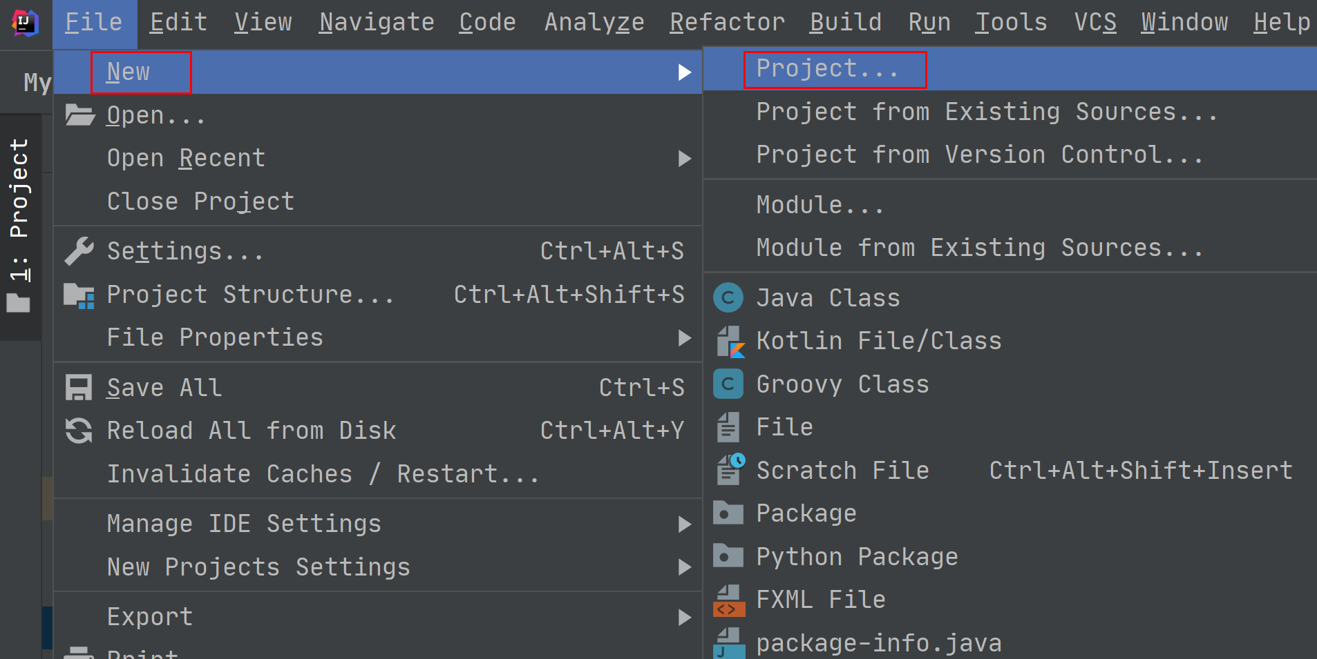

- Start IntelliJ IDEA and choose File > New > Project. Figure 3 Creating a project

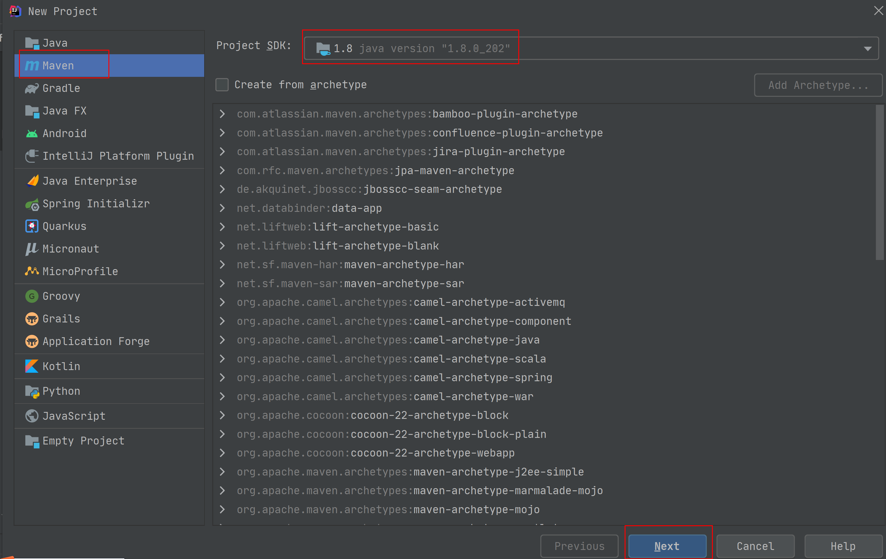

- Choose Maven, set Project SDK to 1.8, and click Next. Figure 4 Creating a project

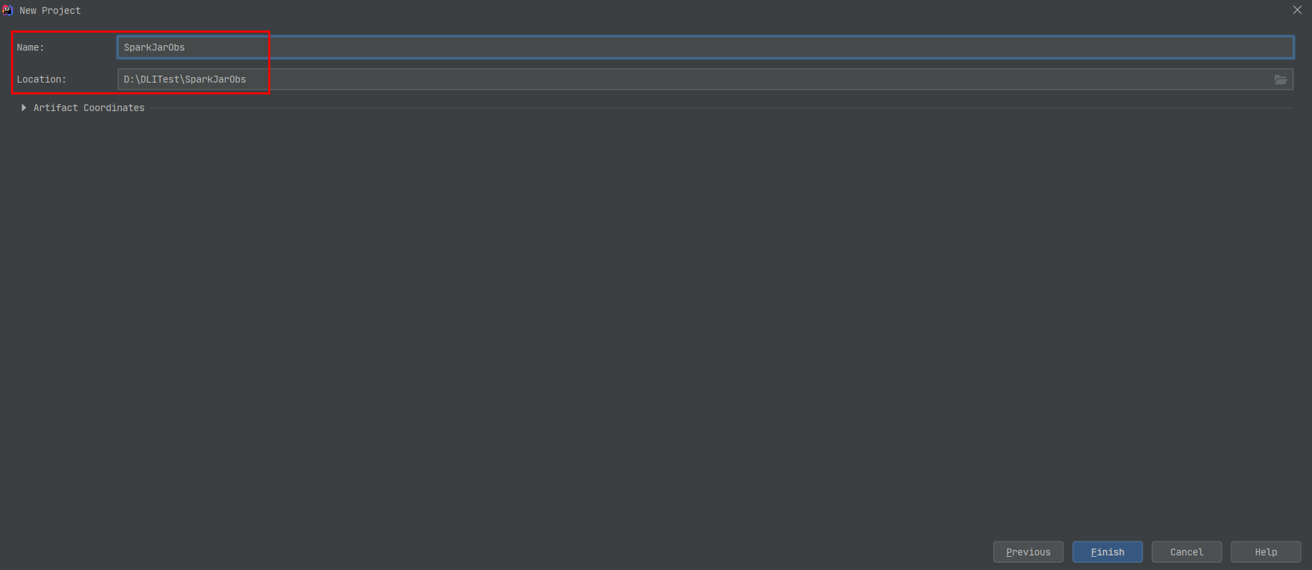

- Set the project name, configure the storage path, and click Finish. Figure 5 Creating a project
In this example, the Maven project name is SparkJarObs, and the project storage path is D:\DLITest\SparkJarObs.

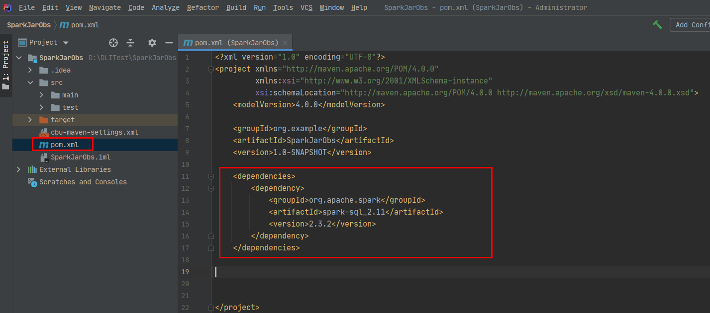

- Add the following content to the pom.xml file.
<dependencies> <dependency> <groupId>org.apache.spark</groupId> <artifactId>spark-sql_2.11</artifactId> <version>2.3.2</version> </dependency> </dependencies>Figure 6 Modifying the pom.xml file

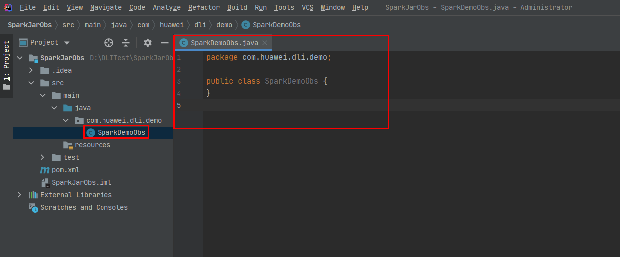

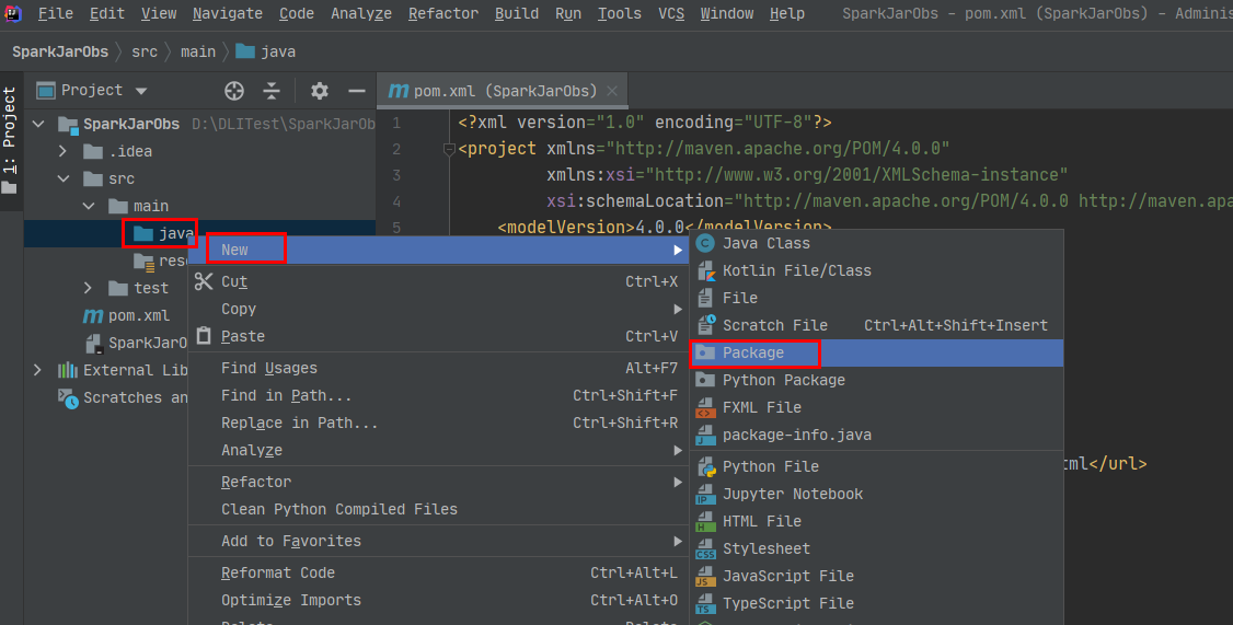

- Choose src > main and right-click the java folder. Choose New > Package to create a package and a class file. Figure 7 Creating a package
Set the package name as you need. In this example, set Package to com.huawei.dli.demo. Then, press Enter.
Create a Java Class file in the package path. In this example, the Java Class file is SparkDemoObs.Figure 8 Creating a Java class file

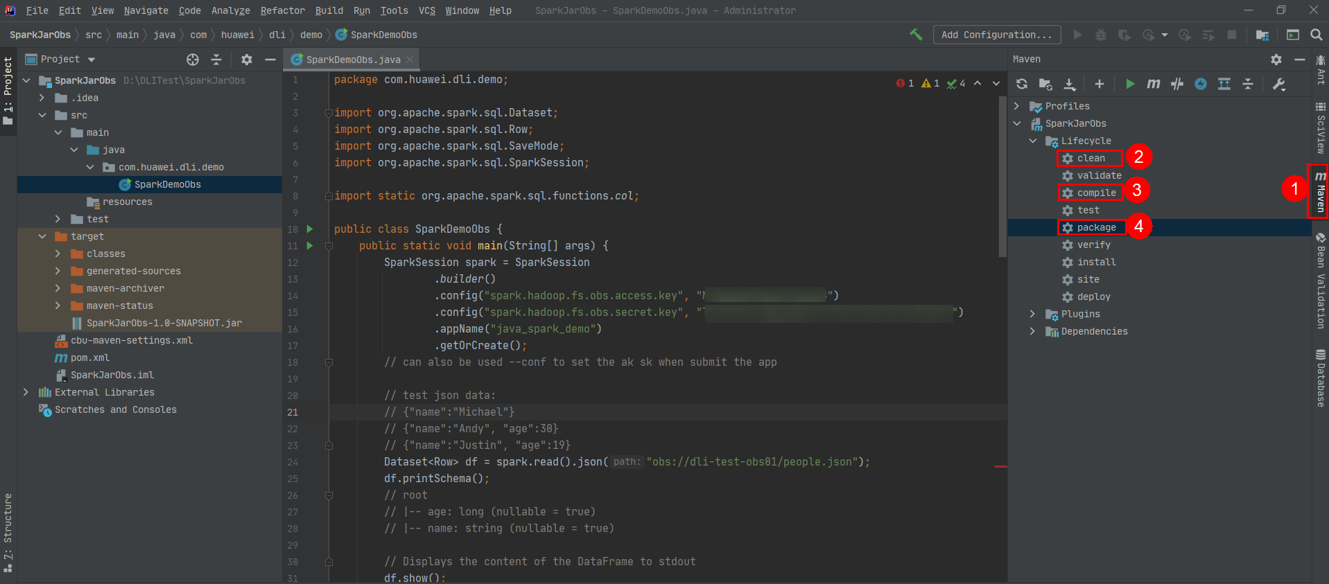

Step 5: Debug, compile, and pack the code into a JAR package.

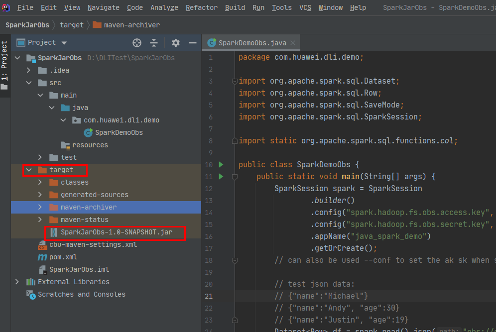

- Double-click Maven in the tool bar on the right, and double-click clean and compile to compile the code. After the compilation is successful, double-click package.Figure 9 Compiling and packaging
The generated JAR package is stored in the target directory. In this example, SparkJarObs-1.0-SNAPSHOT.jar is stored in D:\DLITest\SparkJarObs\target.Figure 10 Exporting the JAR file

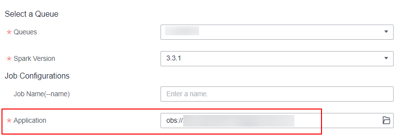

- Spark 3.3 or later:
You can only set the Application parameter when creating a Spark job and select the required JAR file from OBS.
- Log in to the OBS console and upload the JAR file to the OBS path.
- Log in to the DLI console. In the navigation pane, choose Job Management > Spark Jobs.
- Locate the row containing a desired job and click Edit in the Operation column.
- Set Application to the OBS path in 1. Figure 11 Configuring the application

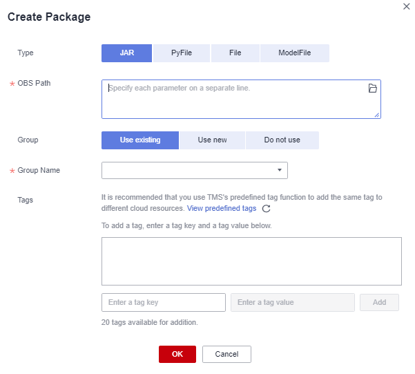

- Upload the file to DLI for package management.
- Log in to the DLI management console and choose Data Management > Package Management.
- On the Package Management page, click Create in the upper right corner.
- In the Create Package dialog, set the following parameters:
- Type: Select JAR.
- OBS Path: Specify the OBS path for storing the package.
- Set Group and Group Name as required for package identification and management.
- Click OK. Figure 12 Creating a package

- Application: Select the package uploaded in Step 6: Upload the JAR Package to OBS and DLI. For example, select SparkJarObs-1.0-SNAPSHOT.jar.
- Main Class (--class): The format is program package name + class name. For example, com.huawei.dli.demo.SparkDemoObs.

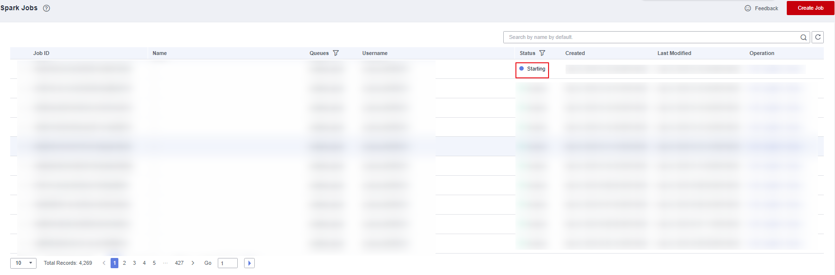

- Click Execute to submit the Spark Jar job. On the Spark Jobs page, check the status of the job you submitted. Figure 13 Job status
Step 8: Check Job Execution Result

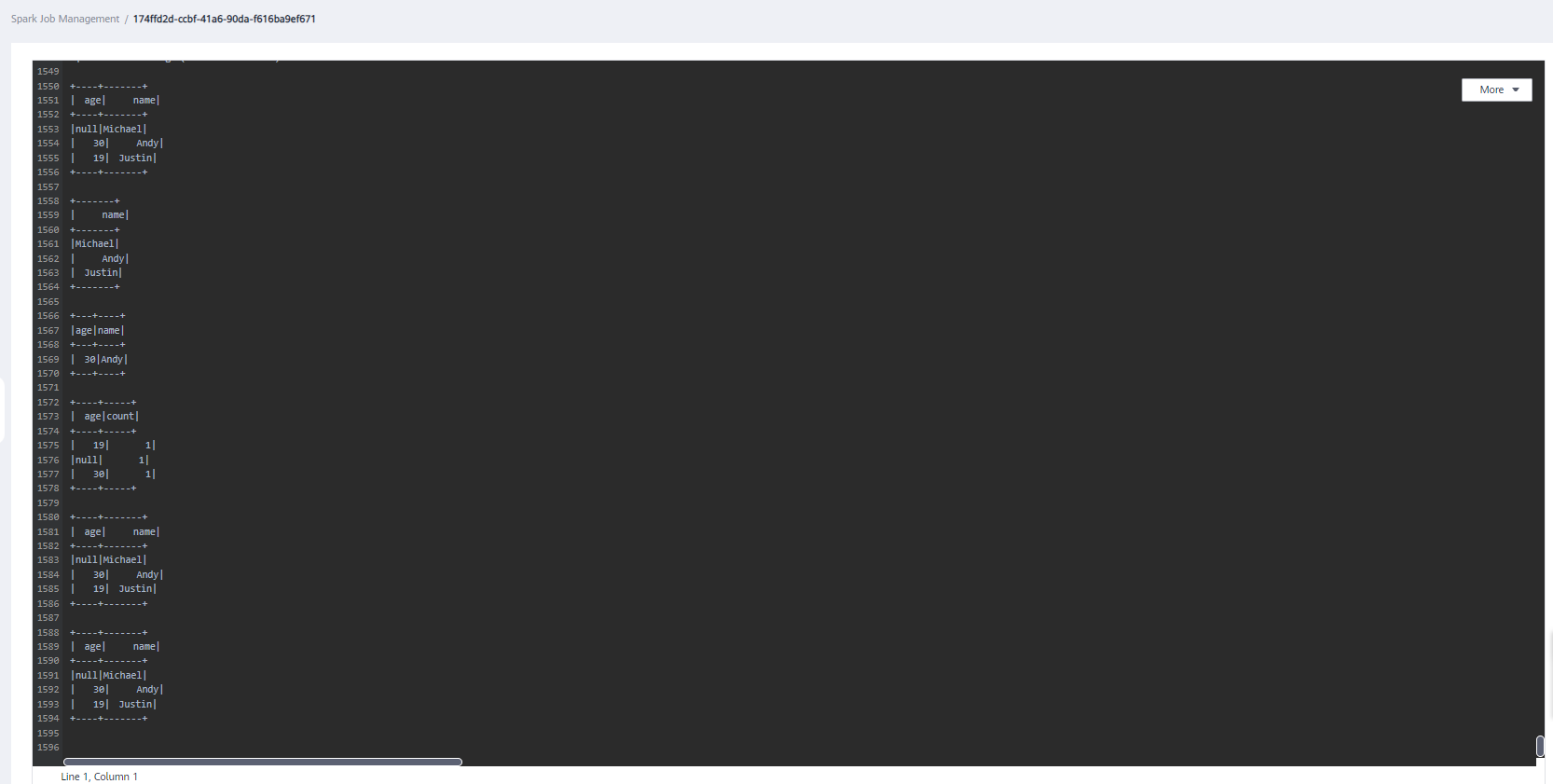

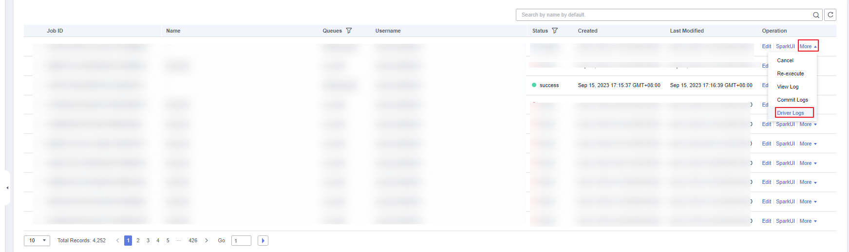

- On the Spark Jobs page, check the status of the job you submitted. The initial status is Starting.
- If the job is successfully executed, the job status is Finished. Click More in the Operation column and select Driver Logs to check the run log. Figure 14 Driver logs

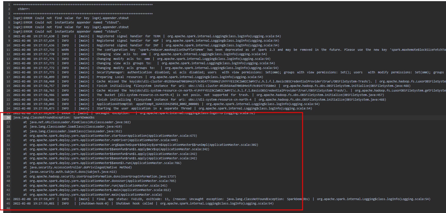

Figure 15 Driver logs
- If the job is successfully executed, go to the result/parquet directory in the OBS bucket to check the generated parquet file.
- If the job fails to be executed, click More in the Operation column and select Driver Logs to check detailed error information. For example, the following figure shows that when you create the Spark Jar job, you did not add the package path to the main class name.Figure 16 Error information
In the Operation column, click Edit, change the value of Main Class to com.huawei.dli.demo.SparkDemoObs, and click Execute to run the job again.

// Displays the content of the DataFrame to stdout
df.show();
// | age| name|
// |null|Michael|
// | 30| Andy|
// | 19| Justin|
// Select only the "name" column
df.select("name").show();
// | name|
// |Michael|
// | Andy|
// | Justin|
// Select people older than 21
df.filter(col("age").gt(21)).show();
// |age|name|
// | 30|Andy|
// Count people by age
df.groupBy("age").count().show();
// | age|count|
// | 19| 1|
// |null| 1|
// | 30| 1|
// Register the DataFrame as a SQL temporary view
df.createOrReplaceTempView("people");
Dataset<Row> sqlDF = spark.sql("SELECT * FROM people");
sqlDF.show();
// | age| name|
// |null|Michael|
// | 30| Andy|
// | 19| Justin|
sqlDF.write().mode(SaveMode.Overwrite).parquet("obs://dli-test-obs01/result/parquet");
spark.read().parquet("obs://dli-test-obs01/result/parquet").show();
