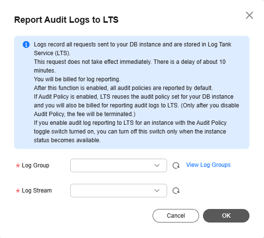

- On the Audit Logs page, click
next to Report Logs to LTS. Figure 1 Enabling Report Logs to LTS
- In the displayed dialog box, specify Log Group and Log Stream. Figure 2 Enabling audit log reporting to LTS
If you enable log reporting to LTS for the first time, click View Log Groups to log in to the LTS console and configure log groups and log streams. For details, see Managing Log Groups and Managing Log Streams.
- Click OK.

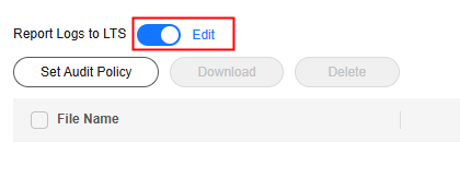

- On the Audit Logs page, click Edit next to the Report Logs to LTS toggle switch.
The editing function is available only when the Report Logs to LTS toggle switch is turned on.

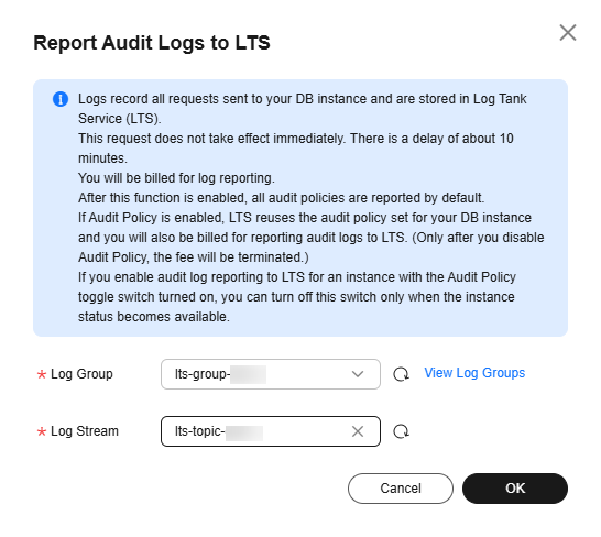

Select the target log group and log stream.
Figure 3 Editing audit log reporting to LTS
- Click OK.

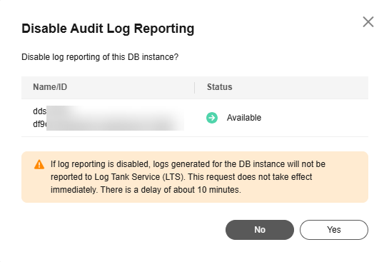

next to Report Logs to LTS. Figure 4 Disabling Report Logs to LTS
- In the displayed dialog box, click Yes. Figure 5 Disabling audit log reporting to LTS

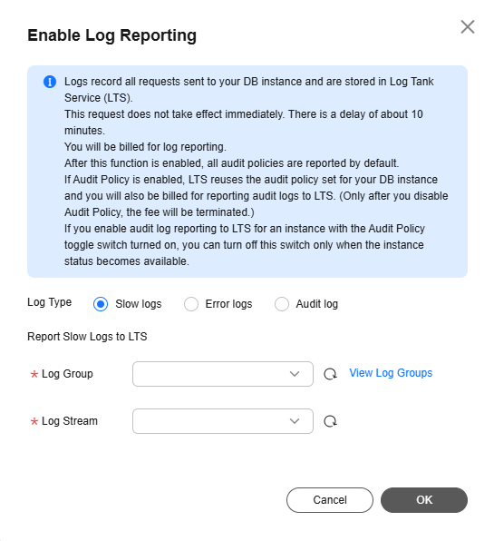

- Select target DB instances and click Enable Log Reporting.
- In the displayed dialog box, specify Log Group and Log Stream. Figure 6 Enabling log reporting to LTS in batches
- Select the target log group and log stream.
- If you enable log reporting to LTS for the first time, click View Log Groups to log in to the LTS console and configure log groups and log streams. For details, see Managing Log Groups and Managing Log Streams.
- Click OK.
