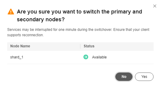

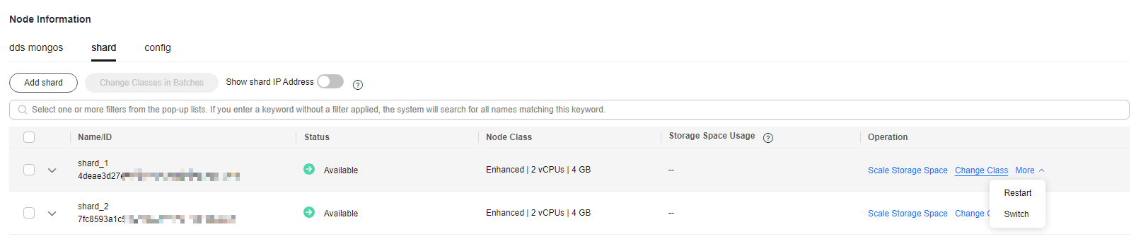

  5. In the Node Information area on the Basic Information page, click the shard tab, locate a target shard node, and choose More > Switch in the Operation column.
    Figure 3 Primary/Secondary switchover
  6. In the displayed dialog box, click Yes.
    Figure 4 Performing a primary/secondary switchover for a shard node
  7. Check the result.
    • During the switchover process, the DB instance status changes to Switchover in progress. After the switchover is complete, the status is restored to Available.
    • In the Node Information area, you can view the switchover result.
    • After the switchover, the previous primary node becomes the secondary node. You need to reconnect to the primary node. For details, see Connecting to a DB Instance.

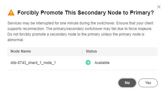

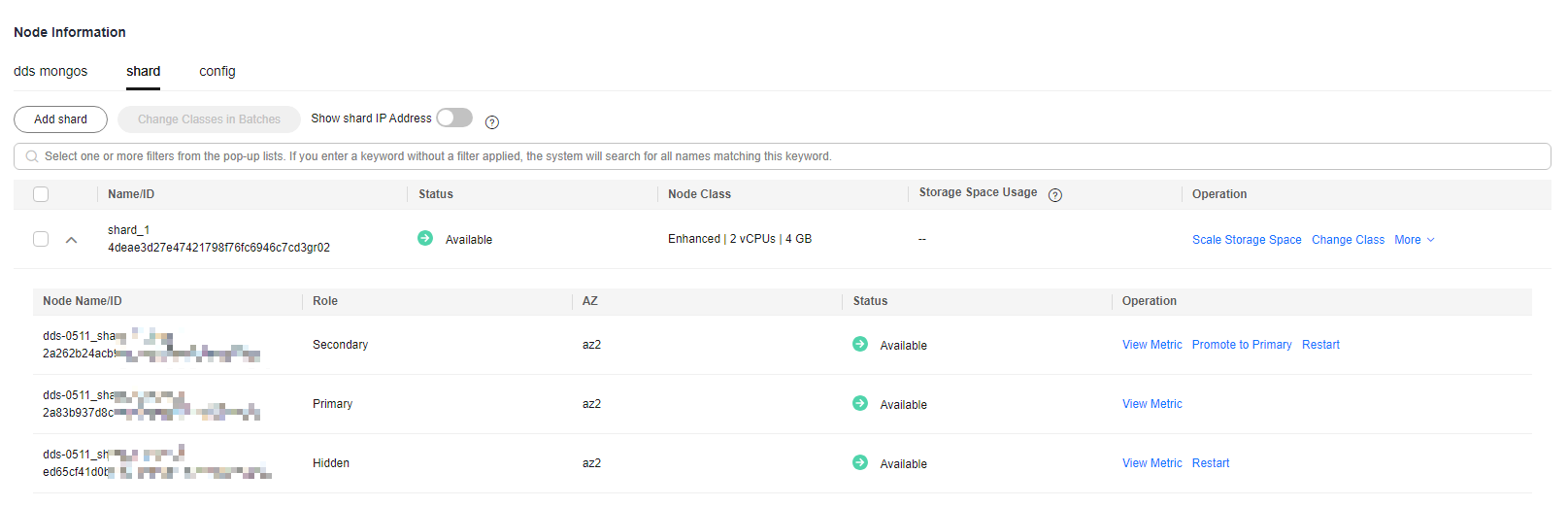

  5. In the Node Information area on the Basic Information page, click the config or shard tab, locate the node whose role is Secondary, and click Promote to Primary.
    Figure 5 Promote to Primary
    Figure 6 Forcibly promoting a secondary node to the primary
    • In the Node Information area on the Basic Information page, you can view the result.
