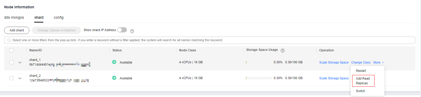

 - In the Node Information area on the Basic Information page, click the shard tab, locate a target shard node, and choose More > Add Read Replicas in the Operation column.
    Figure 1 Node information

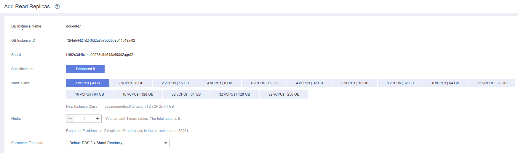

     - On the displayed page, specify Node Class, Nodes, and Parameter Template and click Next.
    Figure 2 Adding read replicas
    Table 1 Parameter description Parameter
Description
Read Replica Parameter Template
The parameters that apply to the read replicas of a cluster instance. After a node are created, you can change the parameter template of the node to bring out the best performance.
