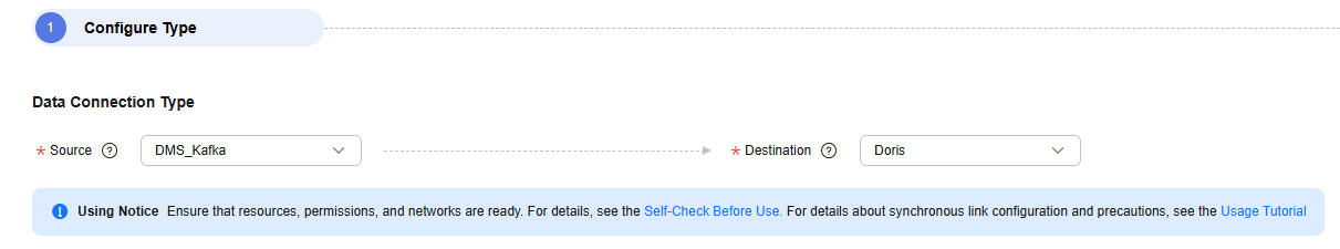

  2. Select the data connection type. Select Kafka for Source and Doris for Destination.
    Figure 1 Selecting the data connection type

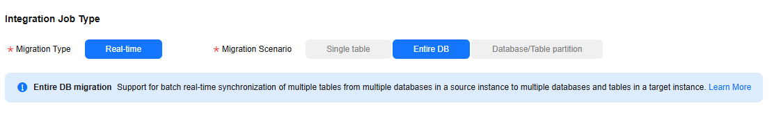

  3. Select a job type. The default migration type is Real-time. The migration scenario is Single table.
    Figure 2 Setting the migration job type
    For details about synchronization scenarios, see Synchronization Scenarios.

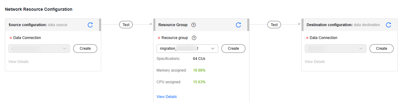

  4. Configure network resources. Select the created Kafka and Doris data connections and the migration resource group for which the network connection has been configured.
    Figure 3 Selecting data connections and a migration resource group
    If no data connection is available, click Create to go to the Manage Data Connections page of the Management Center console and click Create Data Connection to create a connection. For details, see Configuring DataArts Studio Data Connection Parameters.
    If no migration resource group is available, click Create to create one. For details, see Buying a DataArts Migration Resource Group Incremental Package.
  5. Check the network connectivity. After the data connections and migration resource group are configured, perform the following operations to check the connectivity between the data sources and the migration resource group.

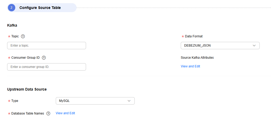

  6. Configure source parameters.
    Select the Kafka topics to be synchronized.
    Figure 4 Entering a Kafka topic
    • Topic
      Enter a Kafka topic to be migrated.
    • Data Format
      Format of the message content in the source Kafka topic. DataArts Migration can process the following message:
      DEBEZIUM_JSON: CDC JSON messages in Debezium format can be parsed and synchronized to the destination table.
    • Consumer Group ID
      A consumer subscribes to a topic. A consumer group consists of one or more consumers. DataArts Migration allows you to specify the Kafka consumer group to which a consumption action belongs.
    • Source Kafka Attributes
      You can add Kafka configuration items with the properties. prefix. The job automatically removes the prefix and transfers configuration items to the underlying Kafka client. For details about the parameters, see the configuration descriptions in Kafka documentation.
    • Upstream Data Source Type
      This parameter is mandatory only when Data Format is set to DEBEZIUM_JSON. Currently, only MySQL is supported, indicating that CDC JSON data is generated by MySQL.
    • Database Table Names
      This parameter is mandatory only when Data Format is set to DEBEZIUM_JSON. It indicates the database tables that Kafka messages come from. The task parses CDC JSON data and synchronizes only the data for which database tables have been configured.

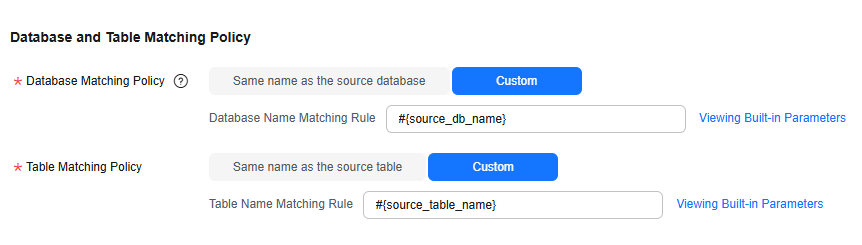

    The source Kafka data in CDC_JSON format may come from multiple upstream database tables. DataArts Migration can match upstream database tables with destination database tables.
    • Set Database and Table Matching Policy.
      • Database Matching Policy
        • Same name as the source database: Data will be synchronized to the Doris database with the same name as the source database.
        • Custom: Data will be synchronized to the Doris database you specify.
      • Table Matching Policy
        • Same name as the source table: Data will be synchronized to the Doris table with the same name as the source table.
        • Custom: Data will be synchronized to the Doris table you specify.
      Figure 5 Database and table matching policy in the sharding scenario
      When you customize a matching policy, you can use built-in variables #{source_db_name} and #{source_table_name} to identify the source database name and table name. The table matching policy must contain #{source_table_name}.

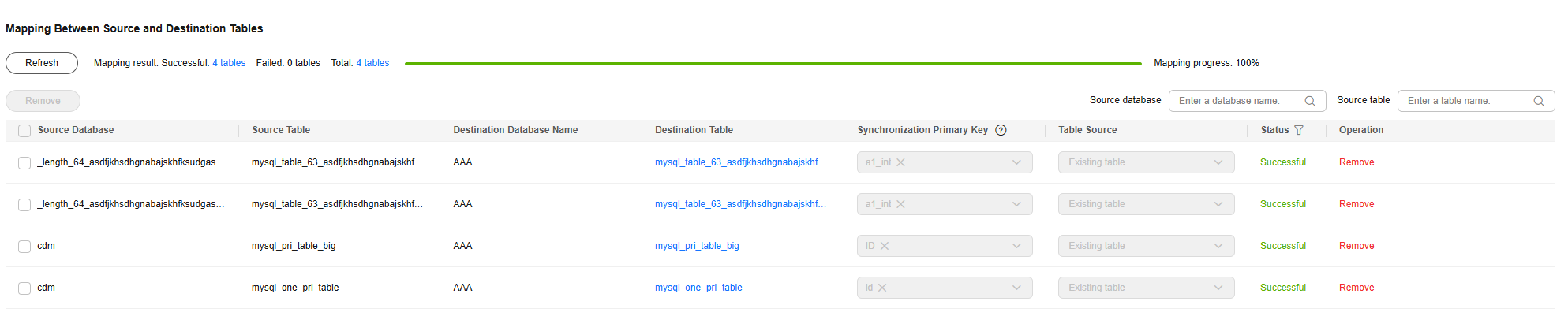

  8. Refresh the mapping between the source and destination tables.
    Figure 6 Mapping between source and destination tables
    • Synchronization Primary Key
      Primary key of the destination Doris table
    • Table Source
      This link does not support automatic table creation. You must manually create Doris tables.
