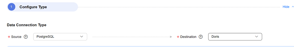

  1. Create a real-time migration job by following the instructions in Creating a Real-Time Migration Job and go to the job configuration page.
  2. Select the data connection type. Select PostgreSQL for Source and Doris for Destination.
    Figure 1 Selecting the data connection type
