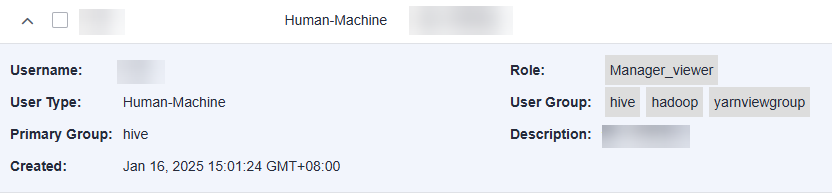

Destination database connection account
The MRS user must have read and write permissions for the Hadoop and Hive components. You are advised to assign the roles and user groups shown in the following figure to the MRS user.
Figure 1 Minimal permissions for MRS Hudi
For details, see MRS Cluster User Permission Model.

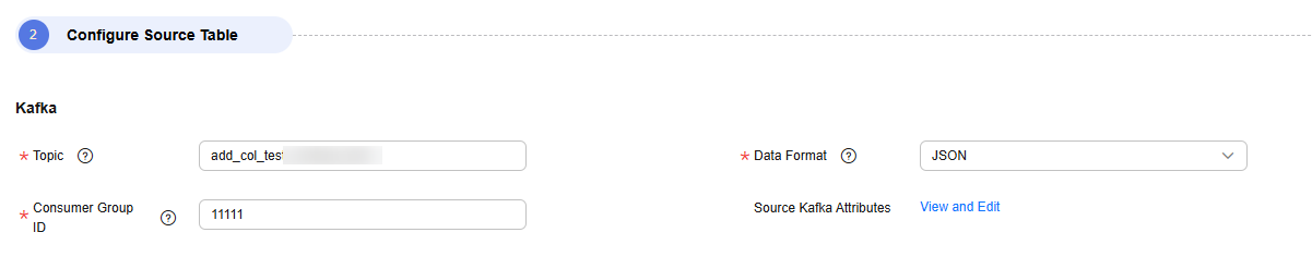

  6. Configure source parameters.
    • Topic
      Enter a Kafka topic to be migrated.
      Figure 5 Entering a Kafka topic
    • Data Format
      Format of the message content in the source Kafka topic. DataArts Migration can process the following types of messages:
      • JSON: Messages can be parsed in JSON format.
      • CSV: Messages can be parsed using specified separators in CSV format.
      • TEXT: The entire message is synchronized as text.
      • DEBEZIUM_JSON: CDC JSON data in Debezium format can be parsed and synchronized to the destination table.
      • CANAL_JSON: CDC JSON data in Canal format can be parsed and synchronized to the destination table.
    • Consumer Group ID
      A consumer subscribes to a topic. A consumer group consists of one or more consumers. DataArts Migration allows you to specify the Kafka consumer group to which a consumption action belongs.
    • Source Kafka Attributes
      You can set Kafka attributes and add the properties. prefix. The job will automatically remove the prefix and transfer the attributes to the Kafka client. For details about the parameters, see the configuration descriptions in the Kafka documentation.

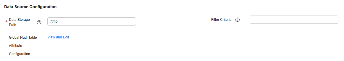

    • Data Storage Path
      Warehouse path when tables are automatically created in Hudi. A subdirectory is created in the warehouse path for each table. You can enter an HDFS or OBS path. The path format is as follows:
      • OBS path: obs://bucket/warehouse
      • HDFS path: /tmp/warehouse
    • Global Hudi Table Attribute Configuration
      Some advanced functions can be configured using parameters. For details, see Hudi advanced parameters.

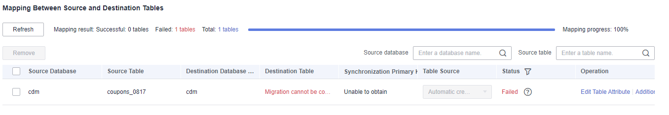

  8. Refresh and check the mapping between the source and destination tables. In addition, you can modify table attributes, add additional fields, and use the automatic table creation capability to create tables in the destination Hudi database.
    If the source is CDC JSON (DEBEZIUM_JSON or CANAL_JSON) data, automatic table creation is not supported. You must manually create a Hudi table.
    Figure 7 Mapping between source and destination tables
    • Synchronization Primary Key
      The primary key must be set for Hudi tables. If the source table has no primary key, you must manually select the primary key during field mapping.
    • Partition Field
      If no Hudi table is available at the destination, you can select a maximum of five mapped destination fields as partition fields. DataArts Migration automatically specifies partitions for a Hudi table when creating the table, and directories are automatically generated for the partitions when data is written to the Hudi table.
      The field selection sequence affects the partition level. For example, if par1 and par2 are selected as partition fields, par1 is a level-1 partition and par2 is a level-2 partition. A maximum of five levels of partitions are supported.

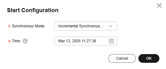

    After submitting the job, click Start on the job development page. In the displayed dialog box, set required parameters and click OK.
    Figure 9 Starting the job
    Table 8 Parameters for starting the job
    Parameter
    Description
    Offset Parameter
    • Earliest: Data consumption starts from the earliest offset of the Kafka topic.
    • Latest: Data consumption starts from the latest offset of the Kafka topic.
    • Start time: Data consumption starts from the offset of the Kafka topic obtained based on the time.
    Minimum Timestamp
    This parameter is required if Offset Parameter is set to Start time. It specifies the start time of synchronization.
    NOTE:
    If you set a time earlier than the earliest offset of Kafka messages, data consumption starts from the earliest offset by default.
