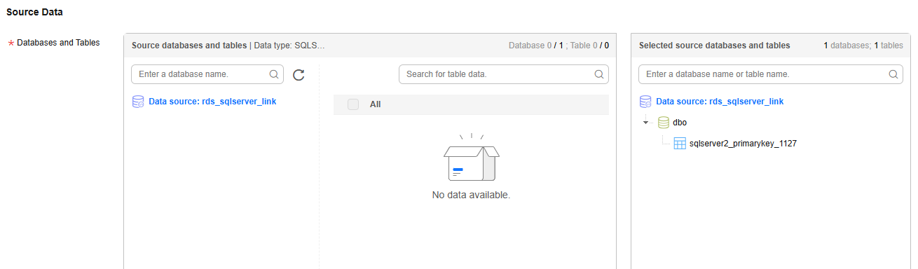

  6. Configure source parameters.
    Select the SQL Server databases and tables to be migrated.
    Figure 5 Selecting databases and tables
    Both databases and tables can be customized. You can select one database and one table, or multiple databases and tables.

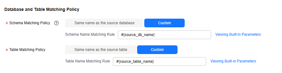

  7. Configure destination parameters.
    • Set Database and Table Matching Policy.
      For details about the matching policy between source and destination databases and tables in each synchronization scenario, see the following table.
      Table 5 Database and table matching policy
      Synchronization Scenario
      Configuration Method
      Entire DB
      • Schema Matching Policy
        • Same name as the source database: Data will be synchronized to the DWS schema with the same name as the source SQL Server database.
        • Custom: Data will be synchronized to the DWS schema you specify.
      • Table Matching Policy
        • Same name as the source table: Data will be synchronized to the DWS table with the same name as the source SQL Server table.
        • Custom: Data will be synchronized to the DWS table you specify.
          Figure 6 Database and table matching policy in the entire database migration scenario
          NOTE:
          When you customize a matching policy, you can use built-in variables #{source_db_name} and #{source_table_name} to identify the source database name and table name. The table matching policy must contain #{source_table_name}.
