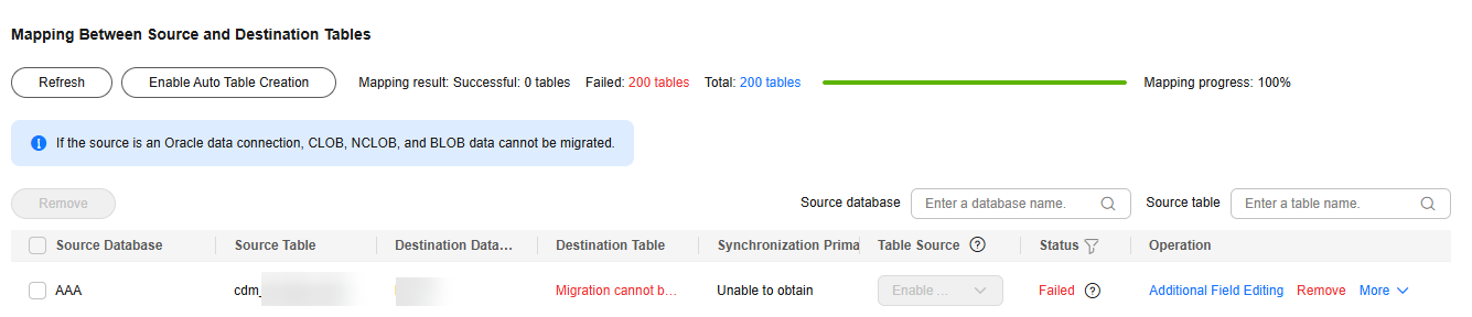

  8. Refresh and check the mapping between the source and destination tables. In addition, you can modify table attributes, add additional fields, and use the automatic table creation capability to create tables in the destination Hudi database.
    Figure 7 Mapping between source and destination tables
    • Synchronization Primary Key
      A synchronization primary key must be set for a Hudi table. If the source table has no primary key, table mapping will fail.

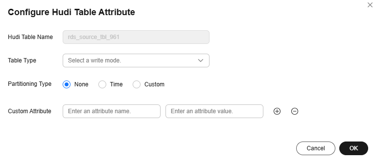

    • Edit Table Attribute
      Click Edit Table Attributes in the Operation column to configure Hudi table attributes, including the table type, partition type, and custom attributes.
      Figure 8 Configuring the Hudi table attributes
      • Table Type: Hudi table type. Select MERGE_ON_READ or COPY_ON_WRITE.
      • Partition Type: partition type of the Hudi table. Select No partition, Time, or Custom.

      • Customize table attributes. Some advanced functions of a single table can be configured using parameters. For details about the parameters, see the table that lists Hudi advanced configurations.
    • Edit additional fields: Click Additional Field in the Operation column to add custom fields to the destination Hudi table. For a new table, you can add additional fields to the existing fields in the source table. You can customize the field name, select the field type, and enter the field value.
      • Field Name: name of the new field in the destination Hudi table
      • Field Type: Type of the new field in the destination Hudi table
      • Field Value: value source of the new field in the destination Hudi table
        Table 9 Additional field value obtaining mode
        Type
        Example
        Constant
        Digits, letters, and special characters are supported. Color emoticons may cause a job submission failure.

    • Automatic table creation: Click Enable Auto Table Creation to automatically create tables in the destination database based on the configured mapping policy. After the tables are created, Existing table is displayed for them.
      Figure 9 Automatic table creation
      • DataArts Migration supports only automatic table creation. You need to manually create databases and schemas at the destination before using this function.
      • For details about the field type mapping for automatic table creation, see Field Type Mapping.
      • An automatically created Hudi table contains three audit fields: cdc_last_update_date, logical_is_deleted, and _hoodie_event_time. The _hoodie_event_time field is used as the pre-aggregation key of the Hudi table.
