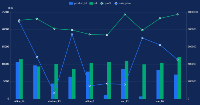

Dual Y-Axis Combination Chart
This section describes the parameters of a dual Y-axis combination chart, which is a chart that combines both a line chart and a bar chart.

Chart Display
Figure 1 Dual Y-axis combination chart
