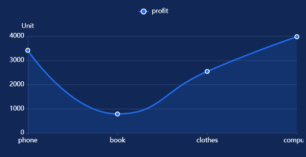

Procedure
  1. In the component area on the left of the large screen page, click Line Chart.
  2. Select the dataset to analyze from the Data area on the right of the dashboard creation page.
  3. Set the parameters on the Fields, Styles, and Interactions tab pages.
  4. Click Update on the Fields tab. The chart data is automatically updated.
    Figure 1 Line chart
  5. Click Save or Save and Publish in the upper right corner to save the large screen.
  6. In the Save Screen dialog box that appears, enter the large screen name and click OK.
