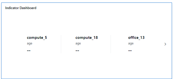

  1. In the top navigation bar on the dashboard creation page, click to create an indicator dashboard.
  2. Select a dataset in the Data area.
  3. Set parameters on the Field, Style, and Advanced tabs.
  1. Click Update. The system automatically updates the chart.
    Figure 1 Indicator dashboard
