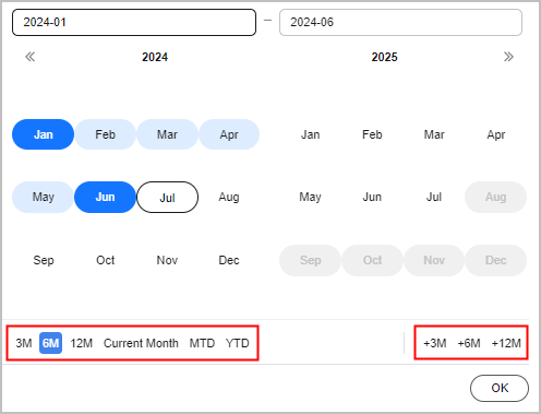

- Specify the period.
- If you want to view the forecasts by the month, the following periods are available: Current Month, +3M, +6M, and +12M.
- If you want to view the forecasts by the day, the following periods are available: Current Month, +1M, and +3M.

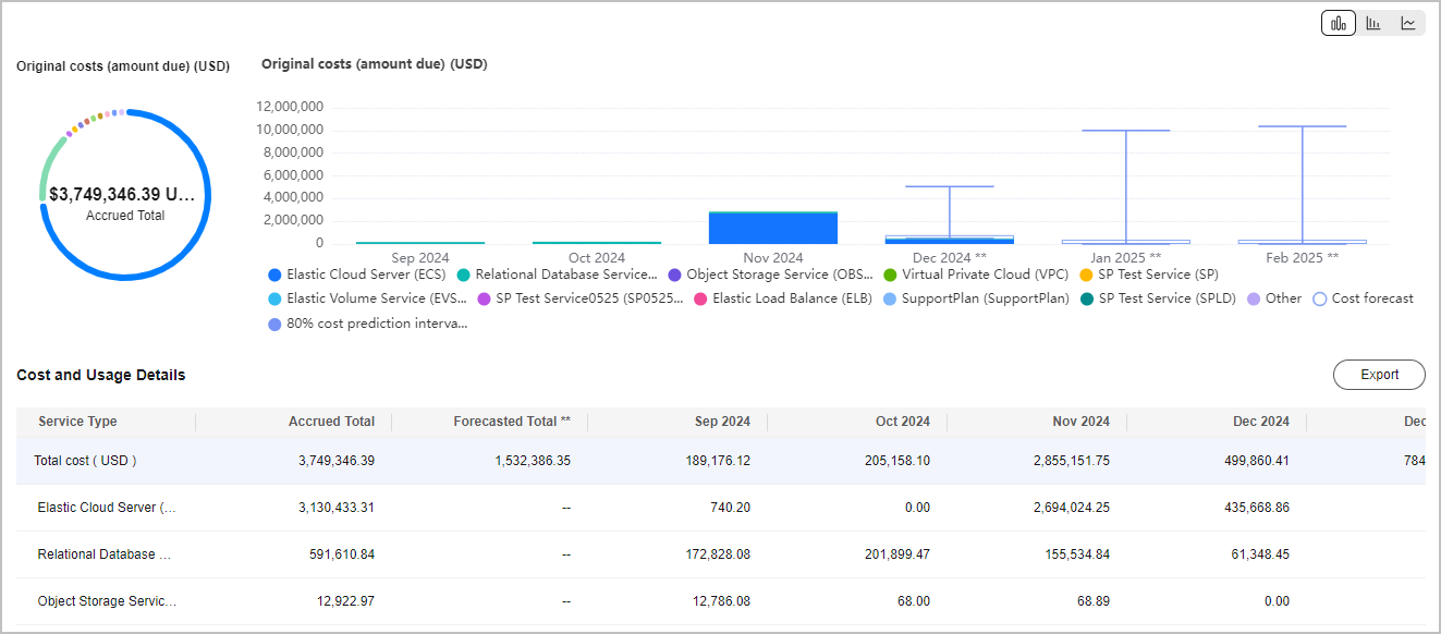

- Click OK. The following page is displayed:
- The blue bars represent the cost data generated in the past few months (including the current month).
- The white bars represent the forecasted cost data for the next few months (including the current month).
Table 1 Parameter description Parameter
Description
Cost forecast
Cost data forecasted by the month or the day.
80% cost prediction interval
80% of your actual costs should fall within the prediction interval.
Accrued Total
Total costs in the past and current months during the statistical period.
You can configure Grouped By to summarize the costs.
Forecast Total
Forecasted total costs in the current and future months during the statistical period.
Costs cannot be summarized by Grouped By.
Total Cost
Total cost in each day or month.

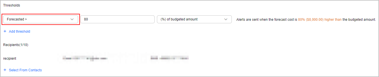

- Under Alert Thresholds, configure Thresholds and Recipients and click Next.
Set Thresholds to Forecast >.
In this example, suppose you have chosen to receive an alert when the forecasted amount is greater than 80% of the budgeted amount.
