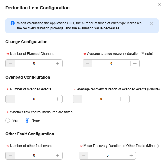

  4. Click Deduction Item Configuration and configure the parameters on the displayed page. If you set a larger number for parameters, the SLO value you calculated for the architecture will be a smaller one.
    Figure 1 Configuring deduction items
    Table 3 Parameters for deduction item configuration
    Parameter
    Description
    Number of Planned Changes
    Number of plan changes within one year.
    Average change recovery duration (Minute)
    Average recovery duration of each change within one year, in minutes.
    Number of overload events
    Number of overload incidents that may occur within one year.
    Average recovery duration of overload incidents (Minute)
    Average recovery duration of each overload incident within one year, in minutes.
    Whether flow control measures are taken
    Flow control switch. If you set this parameter to Yes, the Number of overload events and Average recovery duration of overload events (Minute) parameters are invalid and their values are the default value 0.
    Number of other fault events
    Number of other fault incidents that may occur within one year.
    Mean Recovery Duration of Other Faults (Minute)
    Average recovery duration of other fault incidents within one year, in minutes.
  5. Click OK.

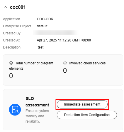

  6. Click Immediate assessment to re-evaluate the SLO value of the architecture.
    The architecture is governed.
    Figure 2 Evaluating an architecture
