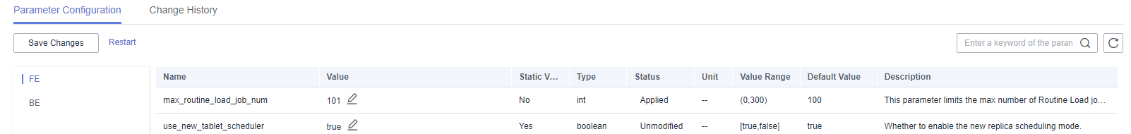

  5. Select the target FE or BE node, select the parameter to be modified, and click in the Value column.
  6. Enter a new value in the text box and click . The system displays a message "The parameter changed to xx successfully. Save the modified value." The new value is followed by a red asterisk (*).
    To cancel the modification, click .
    Figure 1 Modifying a parameter
  7. Click Save Changes in the upper left corner above the parameter list. A dialog box is displayed.
  8. Check the parameter settings and click OK.
    Figure 2 Saving the modification
    • Click in the upper right corner. If Status of the parameter is Applied, the cluster does not need to be restarted. If Status is Unapplied, you need to manually restart the cluster for the modification to take effect.
    • Click Restart in the upper left corner of the Parameter Configuration page. Alternatively, return to the cluster list to restart the cluster.
      Manually restart the cluster after the static parameters are modified. Dynamic parameters take effect after being modified. You do not need to restart the cluster.
    • If the new parameter value is incorrect, click Quick Restore to cancel the modification.
