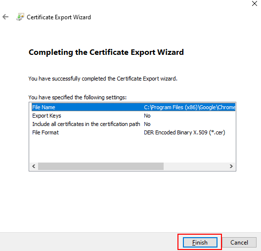

- In the dialog box that is displayed, click the Details tab, click Copy to File, and click Next. (You can also click the Certificate Path tab to export the root certificate or level-2 certificate. The export method is similar.)
- Select a certificate format and click Next.
- Enter the name of the certificate file to be exported and click Next.
- Click Finish to generate a certificate file. The file name is the complete path of the certificate file.
