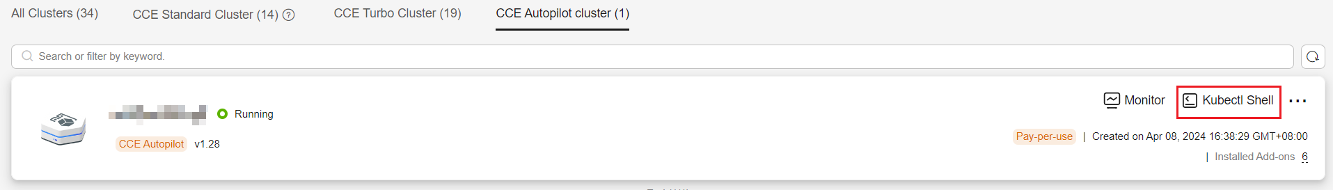

- Log in to the CCE console. In the navigation pane, choose Permissions.
- In the cluster list on the right, locate the target cluster and click CLI on the right to use CloudShell. Figure 1 CloudShell
