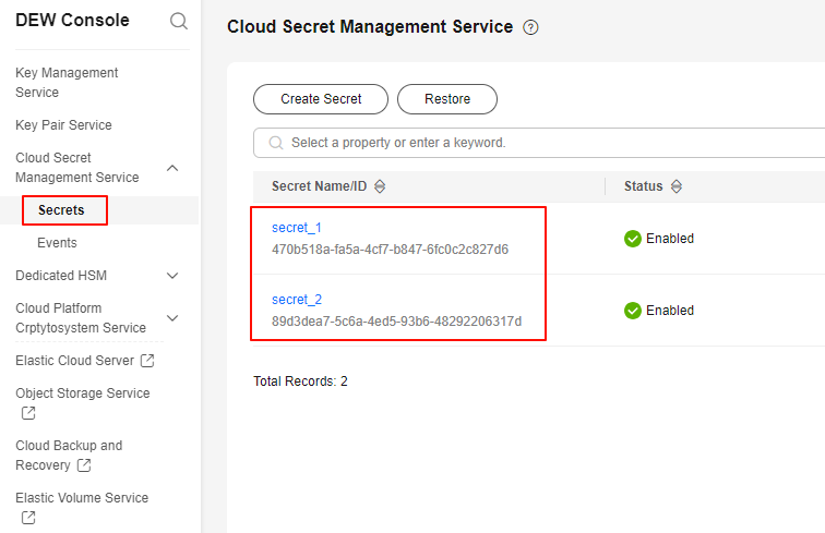

  1. Create a ServiceAccount object to declare the name of the secret that can be used by the service pod. Before you take this step, ensure that the corresponding secret exists in CSMS. If the secret does not exist, an error occurs when the secret is obtained from CSMS. As a result, the pod cannot run normally. For details about how to create secrets in CSMS, see Creating a Secret.
    Figure 1 Secrets in DEW
    Figure 2 Secrets in DEW

  4. Verify the result.
    kubectl get secrets
    The output shows that a secret named my-secret-01 has been created using secret_1 specified in the SecretProviderClass object.
    NAME             TYPE                             DATA   AGE
    default-secret   kubernetes.io/dockerconfigjson   1      33d
    my-secret-01     Opaque                           2      1h

          - objectName: "secret_1"
            objectVersion: "latest"  # change "v1"to "latest"
            objectType: "csms"
After the SecretProviderClass object is updated, the add-on periodically sends a request to CSMS to obtain the value of secret_1 of the latest version and updates the value to the pod that references the SecretProviderClass object. The interval for the add-on to periodically send requests is specified by rotation_poll_interval set in Installing the Add-on.
Real-Time Detection of SecretProviderClass Changes
After a pod runs normally, if a user modifies the secret declared in the SPC object (for example, a secret is added or the version number is changed), the add-on can detect the change in real time and update the secret to the pod. For example, add the secret_2 secret to the SecretProviderClass object. After the SecretProviderClass object is updated, secret_2 is quickly mounted to the pod that references the SecretProviderClass object.
apiVersion: secrets-store.csi.x-k8s.io/v1
kind: SecretProviderClass
metadata:
spec:
  provider: cce
  parameters:
    objects: |
            objectType: "csms"
          - objectName: "secret_2"
            objectVersion: "v1"
            objectType: "csms"
