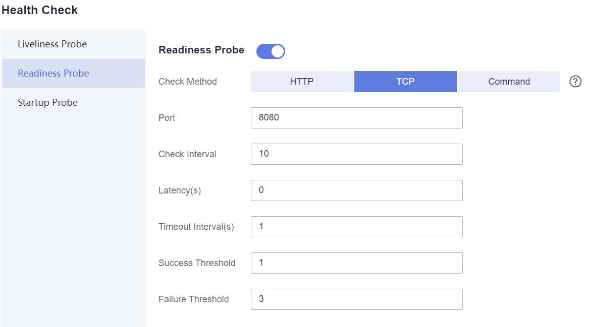

next to Readiness Probe to configure the check method. In this example, the readiness probe must be enabled. - Startup probe checks the running health of application instances. If application instances are unhealthy, CAE restarts them. Click
next to Startup Probe to configure the check method. Figure 2 Readiness probe

- Select a check method and set parameters. For details, see Table 1 and Table 2.
- HTTP: Checks the health of application instances by sending them HTTP requests. Successful access to a healthy instance will return an HTTP status code between [200,399].
- TCP: Checks the health of application instances by sending a TCP socket to instances. Healthy instances will enable a successful TCP connection.

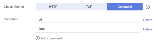

- Command: Runs the probe detection command to check the health of application instances. Healthy instances will enable successful command execution.
Table 1 Check method parameters Check Method
Parameter
Description
HTTP
Port
Port used to establish an HTTP GET connection.
Path
Path used to establish an HTTP GET connection.
Protocol
Select HTTP or HTTPS.
Header
Click Add Header, set the parameter and value, and customize the HTTP header in the request.
TCP
Port
Port for TCP connections. In this example, select TCP.
Command
Command
Add a command. Click Add Command to add more commands.
NOTE:No space is allowed after the command line.
Table 2 Common parameters of the three check methods Parameter
Description
Check Interval
Detection interval, in seconds.
Default value: 10. Minimum value: 1. In this example, use the default value.
Latency
Maximum latency, in seconds.
Default value: 0. Minimum value: 0. In this example, use the default value.
NOTE:If you configure health check before starting the container, set Latency to 3 minutes.
Timeout Interval
Detection timeout interval, in seconds.
Default value: 1. Minimum value: 1. In this example, use the default value.
Success Threshold
Health check is passed after a specified number of consecutive successful detections.
Default value: 1. Minimum value: 1. For liveliness and startup probes, set it to 1. In this example, use the default value.
Failure Threshold
Health check fails after a specified number of consecutive failed detections.
Default value: 3. Minimum value: 1. In this example, use the default value.

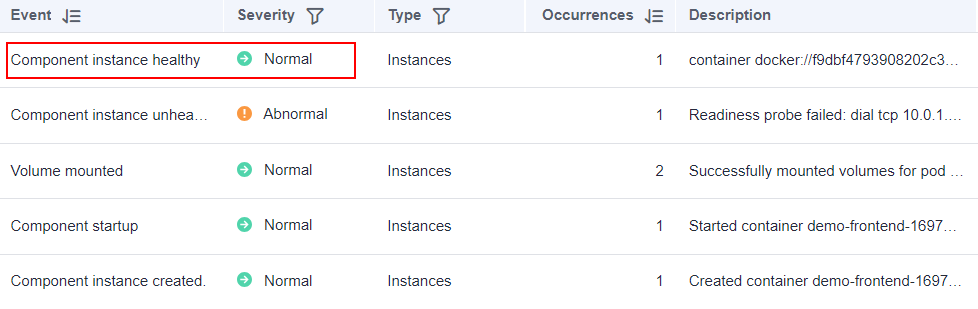

- Verify the component health check function. After upgrading the component, choose Component Events. If the Component instance healthy event is Normal, the component is successfully upgraded. Figure 3 Component health check
