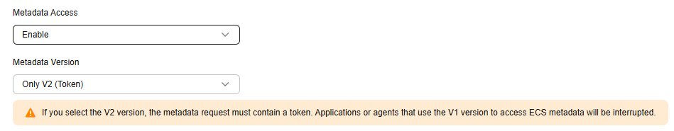

  2. In Advanced Settings, set Metadata Access to Enable.
  3. Set Metadata Version to Only V2 (Token).
    Figure 1 Setting the metadata version
