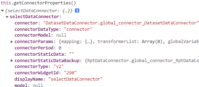

getConnectorProperties
This API is used to obtain connector attributes. There is no input parameter. The usage is as follows:
const connProps = this.getConnectorProperties();
The connProps object contains the information about all data sources connected to the widget.
Figure 1 Data source information
