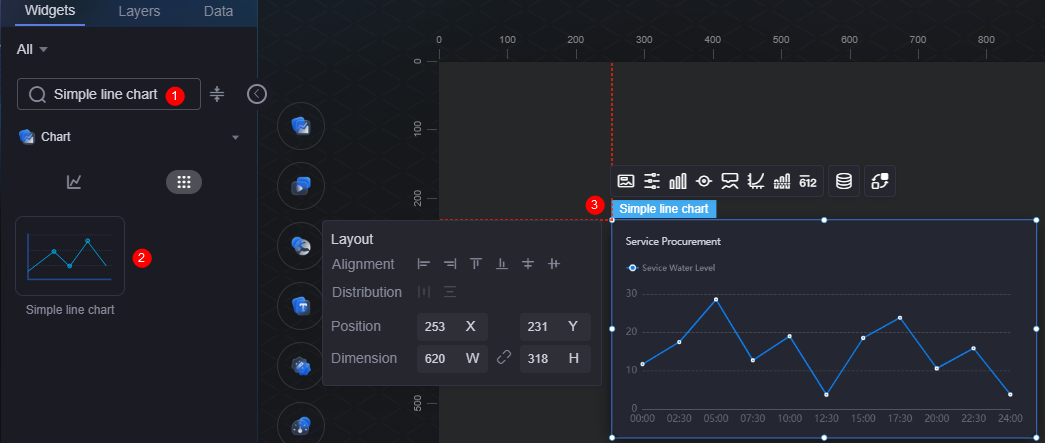

Line Chart
A basic line chart is the basic type of line charts. It displays the data change trend with line changes.
On the large screen design page, drag the line chart widget from All > Chart to the blank area of the canvas, as shown in Figure 1.

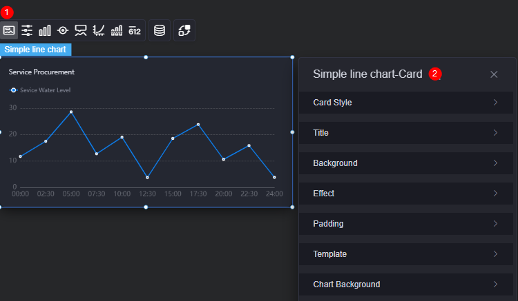

Card
A card wraps a chart widget. A widget consists of card elements (card title, chart, card background, and card border) and chart elements.
- Card style: You can select a card style based on your service requirements. You can click the clear style button to clear the configured style.
- Title: Whether to display the widget title (for example, "Service Procurement" in Figure 3). If you set it to display, you can customize the following attributes of the title:
- Content: Text displayed in the widget title.
- Font: Font style, size, and color of the widget title.
- Alignment: Alignment mode of the title relative to the widget, such as left alignment, center alignment, and right alignment.
- Background color: Background color of the title.
- Padding: Distance between the title and the four sides of the widget box, in pixels by default.
Figure 4 Padding
- Title offset: Distance between the widget title and the line chart.
Figure 5 Title offset
- Background
- Background color: Background color of the widget card.
- Border: Border of the widget card. Options: no border, full border, and corner border. For full border and corner border, you can set the line type and rounded corners of the outer border of the widget.
- Style: Image display style. The options are normal, center, stretch, and tiled.
- Choose image: Use a local image as the widget background. Directories and subdirectories can be added to facilitate image management by category. JPG, JPEG, PNG, and GIF images are recommended. Each image cannot exceed 50 MB.
- Special effect: Widget highlighted status. Displayed by default or on page load.
- Padding: Distance between the chart and the four sides (top, bottom, left, and right) of the widget (see Figure 2). The default value is 0, indicating that the chart spreads across the widget.
- Reference template: Preset widget templates, which can be default or simplified.
- Chart background: Background color, rounded corners, and inner padding of the chart.

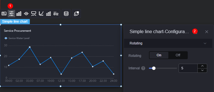

Configuration
In the configuration, you can enable or disable the swiper effect of the widget. After the swiper effect is enabled, the interval cannot exceed 24 seconds.

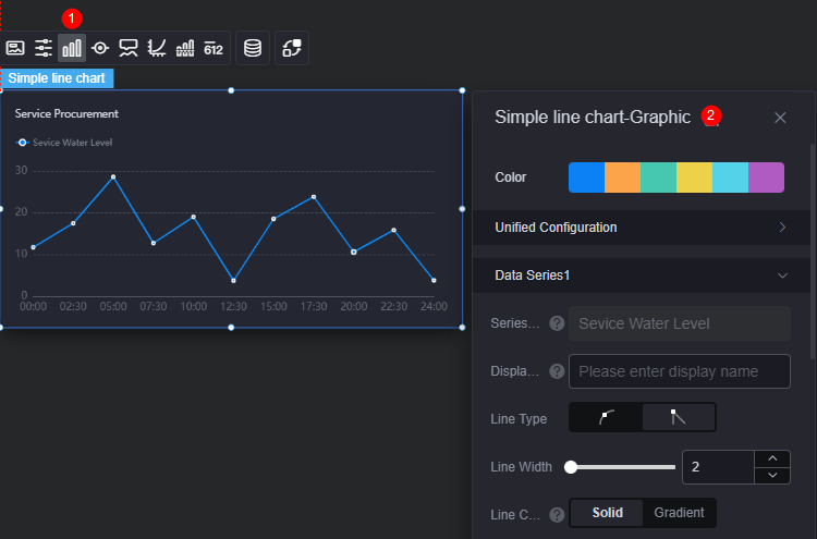

Graphic
A graphic is a specific graphical expression element that visualizes data in a widget. For example, a graphic can be a slice in a pie chart, a bar in a bar chart, or a line or an inflection point in a line chart.
- Color: Color of the chart graphic in the widget.
- Unified configuration
- Line type: Line type of the chart. The options include smooth and unsmooth. When the line type is smooth, the line is similar to a curved line.
- Line width: Line width in the chart. Range: 0–100.
- Kinking point size: Size of kink points. Range: 0–100.
- Data label: Whether to display data labels. If they are displayed, you can set their color.
- Data label (max, min, avg): maximum, minimum, and average values of data labels.
- Data Series
- Series name: Default series name in the raw data. You can change the series name by configuring the display name.
- Display name: Display name of the series in the chart.
- Line color: Pure or gradient. If the reference line is enabled, the gradient changes with the reference line value.
- Polyline opacity: Opacity of polylines.
- Kinking point color: Color of kink points.
- Point opacity: Opacity of kink points.
- Area color: Color of the areas in the line chart.
- Data label: Whether to display data labels. If data labels are displayed, you can set their color, prefix, and suffix.

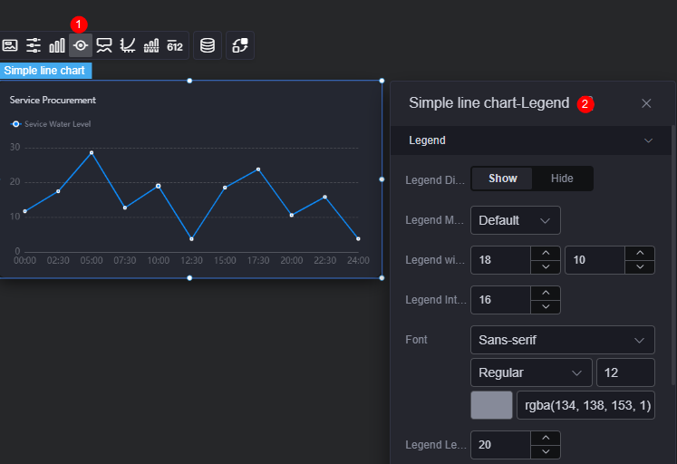

Legend
A legend shows the dimensions in a multi-dimensional visualized graphic expression.
- Legend display: Whether to display the legend. The legend text content comes from the value of s in the data model.
- Legend marker: Shape of legend icons.
- Legend width and height: Width and height of legends.
- Legend interval: Space between legends.
- Font: Font, font color, and font size of legends. The legend text content comes from the value of s in the data model.
- Legend left margin: Distance from the legend to the left of the pie chart widget.
- Legend top margin: Distance from the legend to the top of the pie chart widget.
- Page up button: Color of the page up button.
- Inactivate page turning button: Color of the page up button when it is not activated.
- Custom legend setting: After this function is enabled, you can adjust the display length of the legend name. By default, this function is disabled, that is, all characters in the legend are displayed.

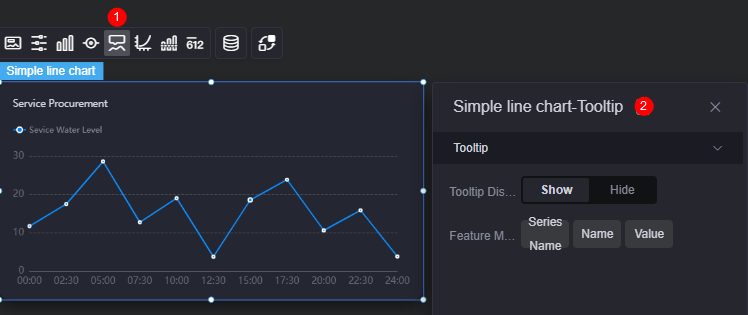

Tooltip
Tooltip (floating prompt) displays metrics of specific dimension nodes in a visualized chart widget.
- Tooltip display: After this function is enabled, the information is displayed when you place the cursor on a specific series during chart preview.
- Feature marker: Content in the tooltip box, such as series name, data name, and data value. Only one or two of them can be displayed.

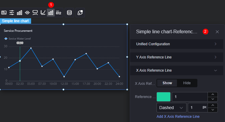

Reference Line
Reference lines are visual markers to help you compare data on charts.
- Unified configuration: Style of the two ends of the reference line, such as circle and rectangle.
- Y axis reference line
- Y axis reference line: Whether to display the Y axis reference line.
- Reference line: Color and type of an existing reference line. To add a reference line, click Add Y Axis Reference Line. To delete a reference line, click x next to it.
- X axis reference line
- X axis reference line: Whether to display the X axis reference line.
- Reference line: Color and type of an existing reference line. To add a reference line, click Add X Axis Reference Line. To delete a reference line, click x next to it.

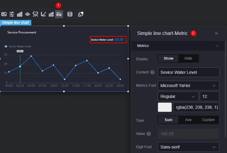

Metrics
Metrics provide supplementary text and number information to a graphic in a widget.
- Metrics display: Whether to display metrics.
- Metrics content: Content of metrics.
- Metrics font: Font, size, and color of the metric content.
- Metrics value type: Metric type, which can be sum, average, or custom.
- Metrics value: Set the value if the metrics value type is custom.
- Number font: Font, size, and color of the data.
- Metrics digit places: Number of digits after the decimal point.
