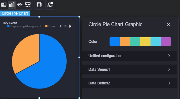

A circle pie chart is a type of pie chart widget. It clearly displays data in a circle on a visualized application.

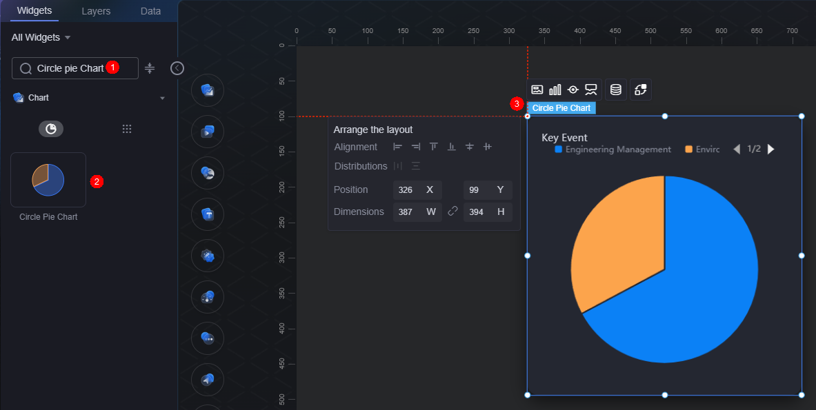

On the large screen design page, drag the circle pie chart widget from All > Chart to the blank area of the canvas, as shown in Figure 1.
Figure 1 Circle pie chart widget

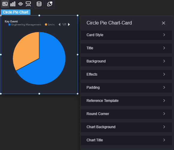

A card wraps a chart widget. A widget consists of card elements (card title, chart, card background, and card border) and chart elements.
Figure 3 Circle pie chart card
  • Card style: You can select a card style based on your service requirements. You can click the clear style button to clear the configured style.
  • Title
    • Title: Whether to display the widget title.
    • Content: Widget title.
    • Font: Font style, size, and color of the widget title.
    • Align: Alignment mode of the title relative to the widget.
    • Title background color: Background color of the title.
    • Padding: Distance between the title and the four sides of the widget box, in pixels by default.
      Figure 4 Padding
    • Title offset: Distance between the widget title and the circle pie chart.
      Figure 5 Title offset
  • Background
    • Background color: Background color of the widget card.
    • Border: Border of the widget card. Options: no border, full border, and corner border. For full border and corner border, you can set the line type and rounded corners of the outer border of the widget.
    • Style: Image display style. The options are normal, center, stretch, and tiled.
    • Choose image: Use a local image as the widget background. Directories and subdirectories can be added to facilitate image management by category. JPG, JPEG, PNG, and GIF images are recommended. Each image cannot exceed 50 MB.
  • Special effect: Widget highlighted status. Displayed by default or on page load.
  • Padding: Distance between the chart and the four sides (top, bottom, left, and right) of the widget (see Figure 2). The default value is 0, indicating that the chart spreads across the widget.
  • Reference template: Preset widget templates, which can be default or marked.
  • Round corner: Round corners of the border. The radian of the four corners ranges from 0 to 500, in pixels.
  • Chart background: Background color of the chart.
  • Chart title: Whether to display the chart title. You can customize the chart title or obtain it from the series.
Graphic
A graphic is a specific graphical expression element that visualizes data in a widget. For example, a graphic can be a slice in a pie chart, a bar in a bar chart, or a line or an inflection point in a line chart.
Figure 6 Circle pie chart graphic

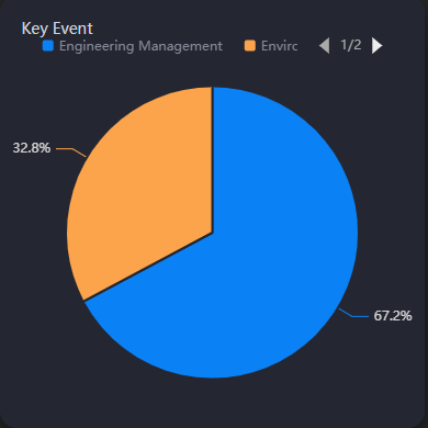

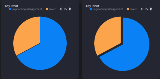

    • Hover effects: Whether a slice stands out on hover.
    • All label settings: Whether to display labels in the chart.
    • All label hover settings: Whether to display labels when you hover the cursor over a specific data series.
    • Label position: inside, outside, or in the middle.
    • Display visual guide line: Whether to add a guide line in front of a label.
      Figure 7 Display visual guide line
    • Guide line length: Length of the label lead line.
    • Label content: Content displayed on the label, which can be a data value (Figure 7), a percentage, or a series name.
    • Label text: Font, size, and color of the label content.
    • Stroke: Stroke style of the circle pie chart series and the overall chart.
    • Background: Background of the pie chart.

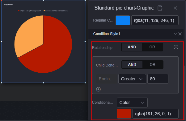

      • Condition color: Add the condition format to set the condition and response data column style. As shown in the following figure, the setting indicates that when the engineering management meets the condition (greater than 80), it will display in red; otherwise, it will show in the normal color.
        Figure 9 Setting the condition style

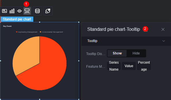

Tooltip
Tooltip (floating prompt) displays metrics of specific dimension nodes in a visualized chart widget.
Figure 11 Circle pie chart tooltip
  • Tooltip display: After this function is enabled, the information is displayed when you place the cursor on a specific series during chart preview.
  • Feature marker: Content in the tooltip box, such as series name, data value, and percentage. Only one or two of them can be displayed.
