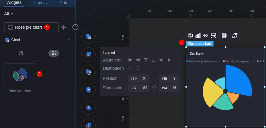

A rose pie chart is a type of pie chart widget and can be specially displayed based on data.
On the large screen design page, drag the rose pie chart widget from All > Chart to the blank area of the canvas, as shown in Figure 1.
Figure 1 Rose Pie Chart

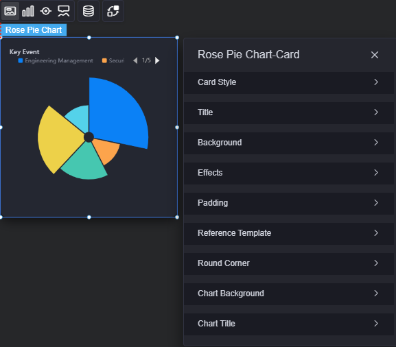

Card
A card wraps a chart widget. A widget consists of card elements (card title, chart, card background, and card border) and chart elements.
Figure 3 Rose pie chart card
  • Card style: You can select a card style based on your service requirements. You can click the clear style button to clear the configured style.
  • Title
    • Title: Whether to display the widget title.
    • Content: Widget title.
    • Font: Font style, size, and color of the widget title.
    • Alignment: Title alignment relative to the widget (left, right, center).
    • Background Color: Background color of the title.
    • Padding: Distance between the title and the four sides of the widget box, in pixels by default.
      Figure 4 Padding
    • Title offset: Distance between the widget title and the rose pie chart.
      Figure 5 Title offset
  • Background
    • Background color: Background color of the widget card.
    • Border: Border of the widget, which can be no, full, and corner. For full border and corner border, you can set the line type and rounded corners of the outer border of the widget.
    • Style: Image display style. The options are normal, center, stretch, and tiled.
    • Choose image: Use a local image as the widget background. Directories and subdirectories can be added to facilitate image management by category. JPG, JPEG, PNG, and GIF images are recommended. Each image cannot exceed 50 MB.
  • Special effect: Widget highlighted status. Displayed by default or on page load.
  • Padding: Distance between the chart and the four sides (top, bottom, left, and right) of the widget (see Figure 2). The default value is 0, indicating that the chart spreads across the widget.
  • Reference template: Chart template, which can be default or labeled.
  • Round corner: Round corners of the border. The radian of the four corners ranges from 0 to 500, in pixels.
  • Chart background: Background color of the chart.
  • Chart title: If you set it to "Display", you can customize the title content, position, font size, and color.

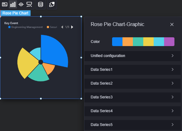

Graphic
A graphic is a specific graphical expression element that visualizes data in a widget. For example, a graphic can be a slice in a pie chart, a bar in a bar chart, or a line or an inflection point in a line chart.
Figure 6 Rose pie chart graphic
  • Color: Color of the graphic.
  • Unified configuration
    • Data series: Whether to display the data series. If this is not selected, the corresponding series of data is hidden from the widget.
    • Nightingale rose chart: Whether to use the Nightingale rose chart.
    • Center angle: If this parameter is set to the same value, the center angle of each segment is the same. The proportion is represented by the segment area. If this parameter is set to different values, the center angles and areas of different segments are different.
    • Inner radius (%): Inner radius of the pie chart.
    • Outer radius (%): Outer radius of the pie chart.
    • Horizontal coordinate of the circle center (%): Horizontal coordinate of the circle center of the pie chart.
    • Vertical coordinate of the circle center (%): Vertical coordinate of the circle center of the pie chart.
    • Arrangement sequence: Slices can be arranged clockwise or anticlockwise.
    • Start angle: Start angle of a slice.
    • Minimum angle: Minimum angle of a slice.
    • Hover effects: Whether a slice stands out on hover.
    • All label settings: Whether to display labels.
    • All label hover settings: Whether to display labels on hover.
    • Label position: inside, outside, or in the middle.
    • Display visual guide line: Configure guide lines for a label.
    • Guide line length: Length of the label lead line.
    • Label content: Whether to display the data value, percentage, and series name on the label.
    • Label text: Font color, size, thickness, and series of the label.
    • Stroke: Stroke style of the pie chart series and the overall chart.
    • Background: Whether to set the pie chart background, including the background color, inner radius, and outer radius.
  • Data Series
    • Series name: Default series name in the raw data. You can change the series name by configuring the display name.
    • Display name: Display name of the series in the chart.
    • Subscript: Location of the data series.
    • Initially selected: Whether a data item is initially selected.
    • Color style: Color style of the data series. The following color styles are supported:
      • Monochrome: Normal colors and highlighted colors are available.
      • Gradient color: You can set gradient style, gradient direction, start color, and end color.
      • Texture: If this parameter is set to texture, upload a texture image. You can set the texture of all data items to be duplicate or unique.
    • Common label: Label when no data series is selected.
      • Display series name: Whether to display a series name in a label, for example, "Engineering Management".
      • Display data value: Whether to display a data value in a label, for example, the data value 635 corresponding to engineering management.
      • Whether to display the percentage: Whether to display the percentage in a label. For example, the percentage corresponding to engineering management is 67.2%.
      • Common label font: Font, color, and size of labels.
    • Highlight label: Label when a data series is selected.
      • Highlight label font: Font, color, and size of labels.

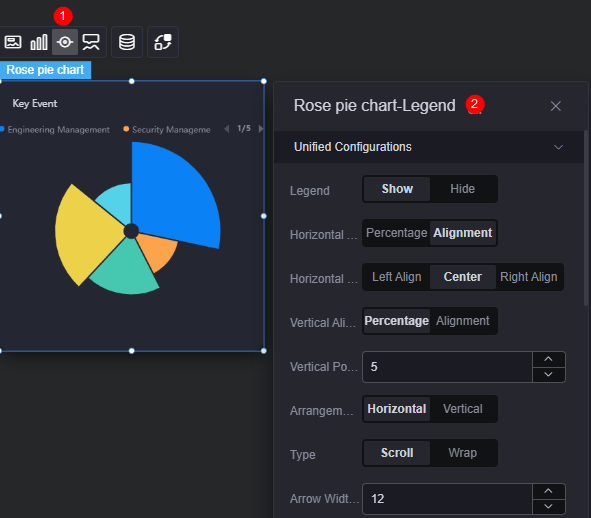

Legend
A legend shows the dimensions in a multi-dimensional visualized graphic expression.
Figure 7 Rose pie chart legend
    • Legend: Whether to display legends, such as "Engineering Management" and "Environment Management". The legend text content comes from the value of s in the data model.
    • Horizontal alignment: Horizontal alignment mode of the legend, which can be left, center, right, and by percentage.
    • Vertical alignment: Vertical alignment mode of the legend, which can be top, center, bottom, and by percentage.
    • Arrangement direction: Arrangement direction of the legend, which can be horizontal and vertical.
    • Type: There are many legends. As a result, not all legends can be displayed in the chart. In this case, you can set the legend type, that is, whether to view legends by scrolling pages or by line break. If this parameter is set to "Scroll", you can set the width and height of the page turning arrow, default icon color, icon selection color, and page number front.
    • Total width and height of legend: Set the width and height of the legend. The unit is %.
    • Legend item width: Set the width of the legend. The width can be automatically set or customized.
    • Legend spacing: Space between legends.
  • Legend marks
    • Legend marks: Shape of the icon before the legend.
    • Mark width and height: Width and height of the icon before the legend.
  • Legend series name
    • Font: Font, color, and size of legends.
    • Legend character: Number of characters displayed in the legend. You can select full display or ellipsis. If this parameter is set to "Ellipsis", you can set the number of characters displayed in the legend.
  • Data value: Whether to display number in the legend. If this parameter is set to "Show", you can set the following parameters.
    • Font: Font, size, and color of the number in the legend.
    • Value left spacing: Space between the series name and data.
    • Prefix: Whether to display the prefix before the number.
    • Prefix content: Set the prefix content to be displayed.
    • Prefix font: Font, size, and color of the prefix.
    • Prefix right spacing: Space between the prefix and the number.
    • Suffix: Whether to display the suffix after the number.
    • Suffix content: Set the suffix content to be displayed.
    • Suffix font: Font, size, and color of the suffix.
    • Suffix left spacing: Space between the suffix and the number.
  • Percentage: Whether to display the percentage. If this parameter is set to "Show", you can set the following parameters.
    • Digital font: Font, size, and color of the number in the percentage.
    • Percent font: Font, size, and color of the % in the percentage.
    • Percent left spacing: Space between the number and percentage.

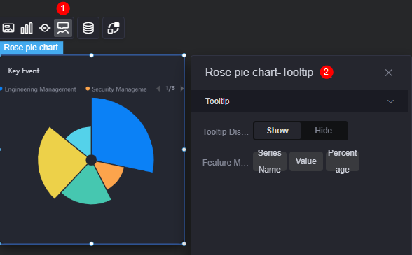

Tooltip
Tooltip (floating prompt) displays metrics of specific dimension nodes in a visualized chart widget.
Figure 8 Rose pie chart tooltip
  • Tooltip display: After this function is enabled, the information is displayed when you place the cursor on a specific series during chart preview.
  • Feature marker: Content in the tooltip box, such as series name, data value, and percentage. Only one or two of them can be displayed.
