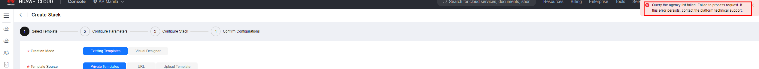

Note: If the error shown in the following figure is displayed, grant permissions to the user by referring to Granting Permissions to Use the RFS Frontend Based on IAM Policies.
