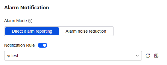

- Set an alarm notification policy. There are two alarm notification modes. Select one as required.
- Direct alarm reporting: An alarm is directly sent when the alarm condition is met.
Enable Notification Rule and select a notification rule. (If Notification Rule is disabled, the alarm rule cannot be created.) The system then sends alarm notifications based on the associated SMN topic and message template. If the existing notification rules cannot meet your requirements, click Add Rule in the drop-down list to create one. For details about how to set a notification rule, see Creating an AOM Alarm Notification Rule.
Figure 2 Setting an alarm notification policy

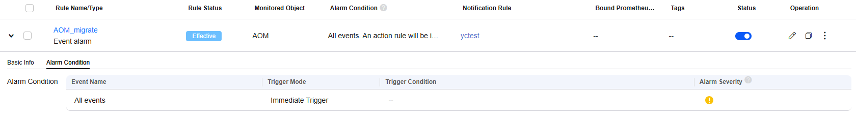

When CCE resources meet the configured event alarm conditions, an event alarm will be generated on the alarm page. To view it, choose Alarm Center > Alarm List in the navigation pane. The system also sends alarm notifications to specified personnel by email or SMS.
Figure 3 Created event alarm rule
