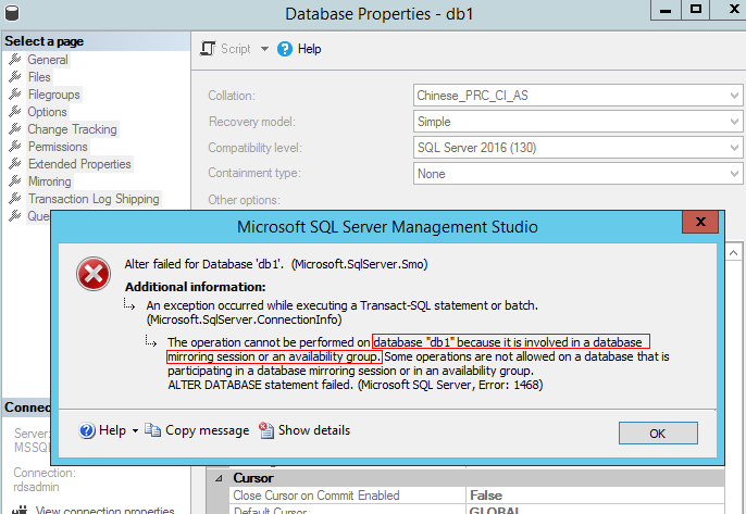

  • Remove the replication temporarily before you change the database name, configure the snapshot isolation level, or set database properties, to avoid an error similar to the following:
    Figure 1 Error message
  • (Not recommended) If your databases have high performance and throughput requirements, you can remove the replication for a longer period of time.
Fault Analysis
The replication needs to be removed before you perform an ALTER DATABASE operation for your database.

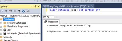

      Run the following SQL statement to remove the replication of your database:
      alter database [@DBName] set partner off
      [@DBName]: name of the database from which you want to remove the replication

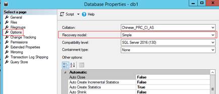

    Remove the replication by following the instructions in 1. If you do not want RDS to automatically re-establish the replication, change the recovery model of the database to Simple in either of the following ways:
    • Log in to the SSMS client, right-click the target database, choose Properties from the shortcut menu, and change the value of Recovery model to Simple.
    • Run the following SQL statement:
      alter database [db1] set recovery simple with no_wait
      In the simple recovery model, no incremental backup is generated. It means that your database cannot be restored to a specified point in time. If you want to restore the replication, set Recovery model to full.

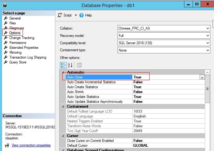

  3. Check the value of the property Auto Close. If Auto Close of your database is set to True, no replication can be established and no replication alarm is generated.
    To restore the replication, change the value of Auto Close to False.
    alter database [db1] set auto_close off with no_wait
