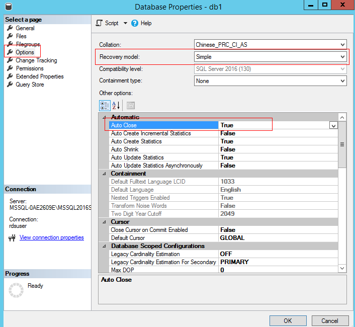

Check the properties of the database for which no replication is set up.
Log in to the SSMS client. Right-click the problem database and choose Properties from the shortcut menu to view the values of Recovery model and Auto Close.
Figure 2 Viewing database properties
  • If Recovery model is set to Simple, no replication can be established. Change it to full through the SSMS or run the following SQL statement:
    ALTER DATABASE [database_name] SET RECOVERY FULL WITH NO_WAIT
    [database_name]: name of the database
    Example:
    ALTER DATABASE [db1] SET RECOVERY FULL WITH NO_WAIT
  • If Auto Close is set to True, no replication can be established, either. Change it to False through the SSMS or run the following SQL statement:
    ALTER DATABASE [db1] SET AUTO_CLOSE OFF WITH NO_WAIT
Replication setup begins several minutes after the modification is complete. The time required for establishing a replication depends on how much data there is.
After the replication is established, change the instance class or perform a primary/standby switchover again.
