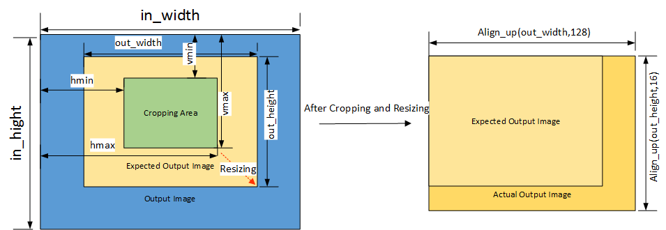

Figure 1 Cropping and resizing process
Figure 1 shows the cropping/resizing process. This process crops the region of interest (ROI) and uses the cropped area for re-sampling. The process of cutting out the ROI is called cropping, and the process of re-sampling is called resizing. When the resizing coefficient is 1, only cropping is performed. When the original image is the cropping output, only resizing is performed.
