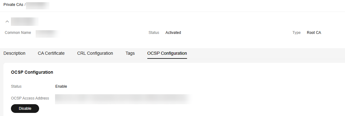

- On the private CA details page, click the OCSP Configuration tab and configure the verification protocol for certificate revocation status, as shown in Figure 1. Table 1 describes the parameters.
Table 1 Configuration parameters Parameter
Description
Status
Indicates the private CA OCSP status. The value can be:
- Enabled: The private CA OCSP is enabled.
- Disabled: The private CA OCSP is disabled.
OCSP Access Address
Indicates the server address provided by the CA, that is, the OCSP server URL, which is used to query whether a digital certificate has been revoked in real time.
- Enables or disables OCSP.
- Click Enable. If Enabled is displayed, OCSP is enabled successfully.
- Click Disable. If Disabled is displayed, OCSP is disabled successfully.
