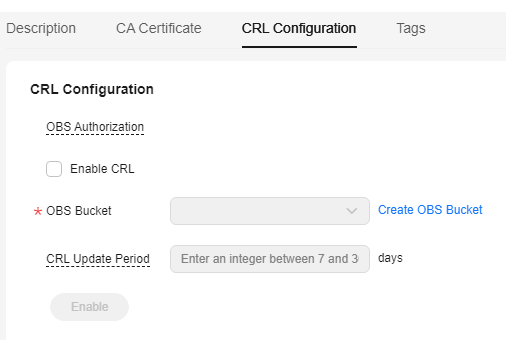

- On the private CA details page, click the CRL Configuration tab and configure certificate revocation by referring to Table 1.
Figure 1 CRL Configuration
Table 1 Certificate revocation parameters Parameter
Description
OBS Authorization
Whether to authorize PCA to access your OBS bucket and upload the CRL file.
If you want to authorize, click Authorize Now and complete the authorization as prompted.
If you want to cancel the authorization, go to the IAM console to delete the agency from the agency list.
Once you complete the authorization, it will not be required again in the subsequent operations.
Enable CRL publishing
Whether to enable CRL publishing.
OBS Bucket
Select an OBS bucket you already have or click Create OBS Bucket to create an OBS bucket.
CRL Update Period
Indicates the CRL update period. PCA will generate a new CRL at the specified time.
You can set the period to an integer between 7 and 30. If you do not specify a value, it is set to 7 days by default.
- Click Enable to enable the CRL. If the system displays a message indicating that the CRL configuration is enabled, the CRL configuration has been enabled.
