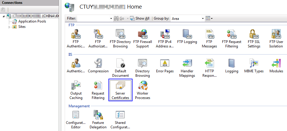

- Open the IIS management console, double-click Server Certificates, as shown in Figure 1.

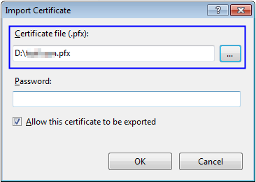

- In the displayed dialog box, click Import, as shown in Figure 2.
- Import the server.pfx certificate file. Then click OK. In the Password box, enter the password provided in the keystorePass.txt file.Figure 3 Importing a PFX certificate file

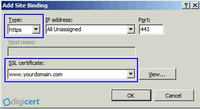

- Right-click the target site (the default site is used as an example). Choose Edit Bindings from the shortcut menu, as shown in Figure 4.
- In the dialog box that is displayed, click Add. Then enter the following information. Figure 5 Binding a website
- Type: Select https.
- Port: Retain the default port 443.
- SSL certificate: Select the certificate imported in 4.
- Click OK.
