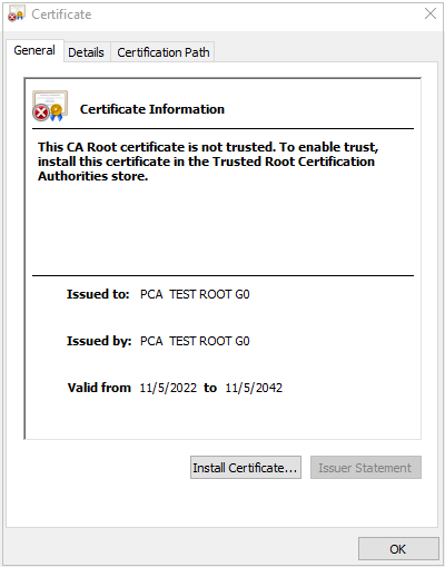

- Change the file name extension of the root CA certificate from .pem to .crt and double-click the certificate file. The root CA certificate information shows that the root certificate is untrusted. Figure 1 Untrusted root CA

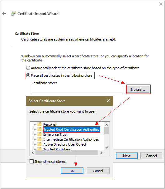

- As shown in Figure 2, select Place all certificates in the following store and click Browse. Then, select Trusted Root Certification Authorities and click OK.

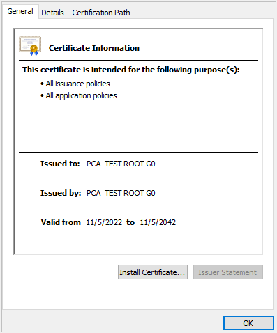

- Double-click the root CA certificate file. If the Certificate Information area shows that the system trusts the root CA certificate, the root CA is added to the trusted root CAs. Figure 3 Trusted root CA

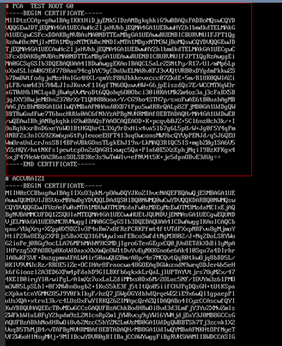

view /etc/pki/tls/certs/ca-bundle.crt
Figure 4 Root CA certificate added to the trusted CA list
